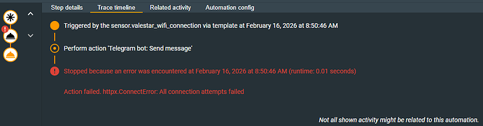

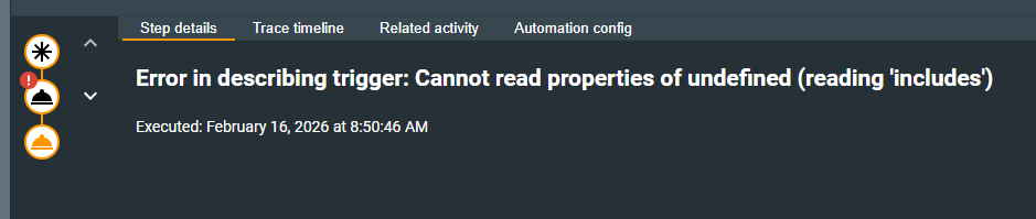

I can see this error:
but how to fix it?
the weird thing is that the error is random… it seems that the error is generated by the telegram notifier.
it works most of the time, but sometimes it gives this error.
but how to debug it?

According to the second screenshot you posted, the automation’s Template Trigger did trigger but then it encountered a problem afterwards (while attempting to send a Telegram message). That’s not a problem with the Template Trigger but with the Telegram action.
thanks for the reply, I found the issue, there was a mismatch in the docker networks, I fixed it, problem solved :slight_smile:
thanks!
Can you explain how that prevented the Telegram bot’s ability to send a message?
