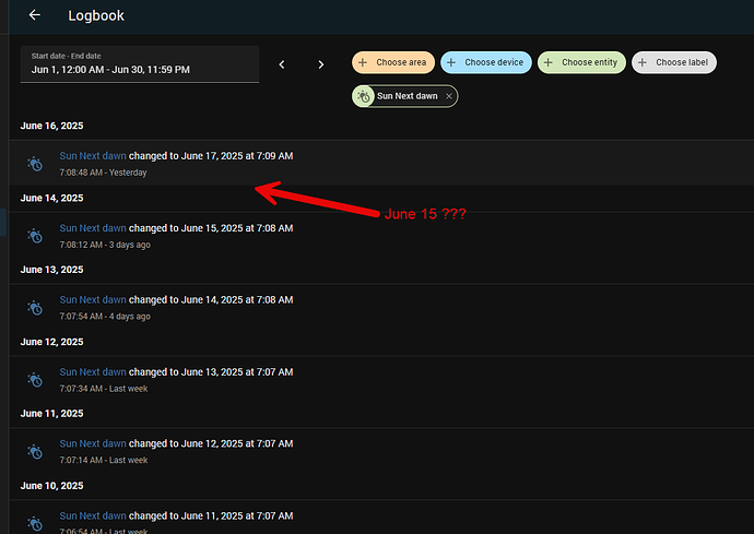

Years later and this is still happening. But I figured out why. The trigger relies on:
triggers:
  • at: sensor.sun_next_dawn
    trigger: time
I checked the logs and this is not triggered by Home Assistant if it was rebooted that day (update, etc.)
See the attached screenshot. See the missing day? Home-assistant was rebooted (OS updated) that day.
I could not find any GitHub issue open about this. Home Assistant runs inside a Hyper-V machine using Home Assistant OS.
