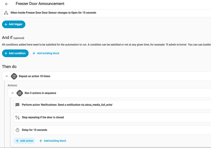

I can’t get this to work and chatgpt hasn’t helped much. The use case is pretty simple, if the freezer door gets left open, tell me until its shut OR you have told me X times.
This configuration seems like it should do it, but it results in each action occuring x times in a row, so the notification happens 10 times, then it checks the door state 10 times, then it delays 105 times.

The primary issue with your version is your stop condition was inverted (I changed off to on because the test continues (when true) not aborts.
The rest of the changes I made, were just cleanup.
  • You had unnecessary nested sequences.
  • I swapped the order of the notify and the wait.
  • I removed the “on for” check since the 15 second delay will effectively do the same thing.
Thanks David, your fix addressed it, for the benefit of anyone else reading and who didn’t want to make my mistakes
I interpreted “Perform an action” singular as it would only do a singular next step so I did an extra step of nesting so it saw my multiple steps as a single one- looks like it actually will perform everything after whether it is an action or actionS
I was interpreting the condition as an If X then Exit its instead a If X then continue, if false Exit. I also thought it would stop the loop so placement didn’t really matter, it seems the loop continues to the max every time but the condition just stops evaluating subsequent steps each time the loop fires

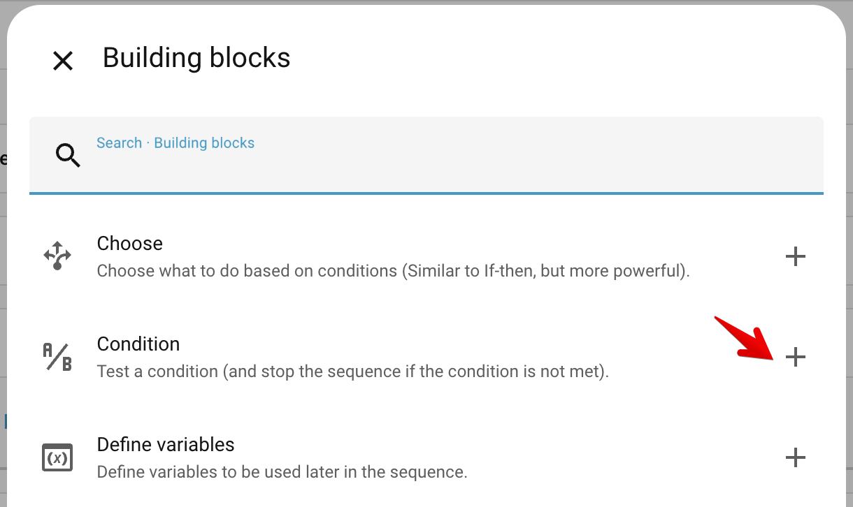

TBF, I was also confused on the behavior of the “Condition building block”:
I wasn’t able to find any documentation describing it’s exact behavior with respect to control structures such as loops and conditionals.
Some experimentation seems to indicate that when the condition evaluates to false the current “sequence” that the condition belongs to aborts its execution or to say that another way execution "goto"s the end of the current sequence.
Higher level structures; loops, ifs or just nested sequences are not affected.
Further I would say the word “stop” (in the description above) is at best confusing, a better word would be “skips” (the remainder of the sequence).
