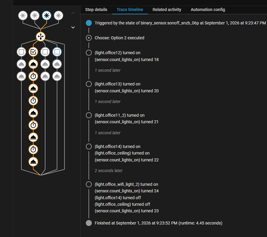

I have tried looking at the actions the automation has triggered in particular when the presence sensor becomes occupied and it is dark such as at 9.23 this evening.
I can see that after turning on the light.office_14), this is followed by setting the group ‘light_office ceiling’ to be on. That is a group of all four ceiling lights. There is a setting in the Lights_office_ceiling ‘All entities’ so the group is on only when all the members of the group are on. Hence setting light,office_14 to on, being the last of the four, means that the group should now be on. Thus I assume this is ok.
It then goes and turns on the wifi light, as per the automation.
But then for an unknown reason off office_14 is turned off and then the group is turned off! That is not part the automation. I have no idea why that is?
