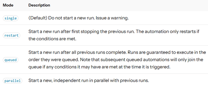

Have you tried changing the mode?

I tried all four modes with no luck.
