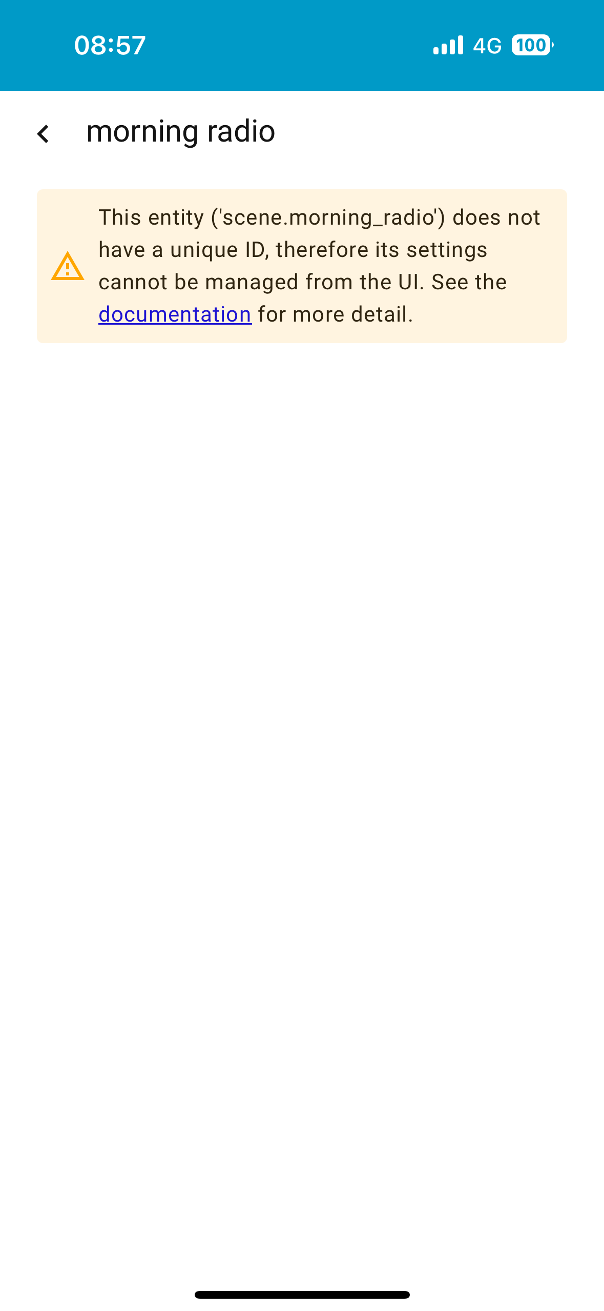

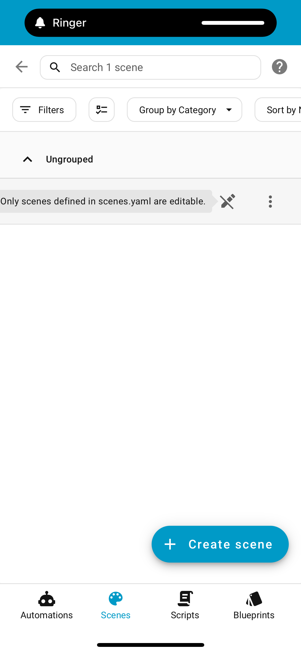

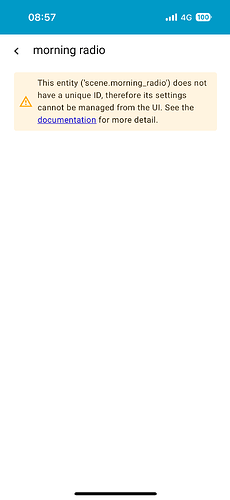

Trying to delete the old Orphaned Scene now
