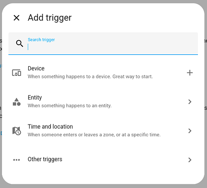

If you’re using the GUI the trigger type would be “Time and Location”.
