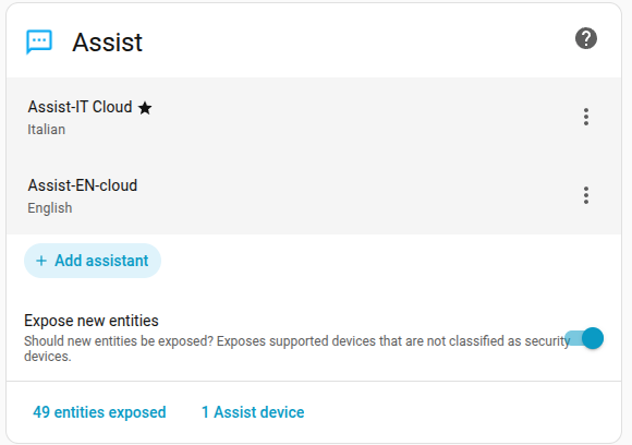

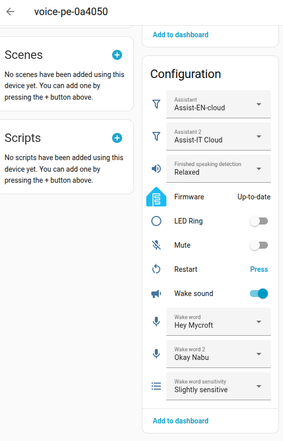

I have installed a HA Voice PE and added Italian as well as English assistants, with “Okay Nabu” running Assist-IT-cloud with a female voice; and “Hey Mycroft” running Assist-EN-cloud with a male voice. So far so good.

But now when I say “Hey Mycroft, good morning” the blind goes up and I get a female voice saying “have a great day” in a strong Italian accent. While not unpleasant, i don’t think this was intended. Somehow the automation has switched from English voice assistant (Hey Mycroft) to Italian assistant (female voice and accent) yet using the English pronunciation.

Looking at this again, maybe it’s significant that Italian is the first and preferred assistant. Maybe somewhere in TTS it is defaulting to the voice (but not the language) of the first assistant ?

and surprised my partner when she said “Okay Nabu, Buongiorno” to trigger the “good morning-IT” automation, then heard the unexpected male english voice trying to pronounce “Buona giornata” badly. So it seems that the Automations Assist satelite: Announce is simply using the first listed language - not the assistant which was triggered by the wake word.
