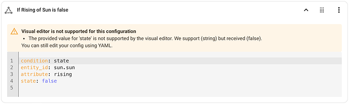

this is so true, in this case, the only way to make it work in the GUI is by editing YAML. As everything is treated as a string, this should be a bug:
This is the only way to make it work. If you enter false in the UI it takes it as a string, so "false" is taken as a true

This is not working (it says condition is not met):
condition: state
entity_id: sun.sun
attribute: rising
state: true
But this is working:
condition: template
value_template: “{{ is_state_attr(‘sun.sun’, ‘rising’, true) }}”
Could it be a bug?
