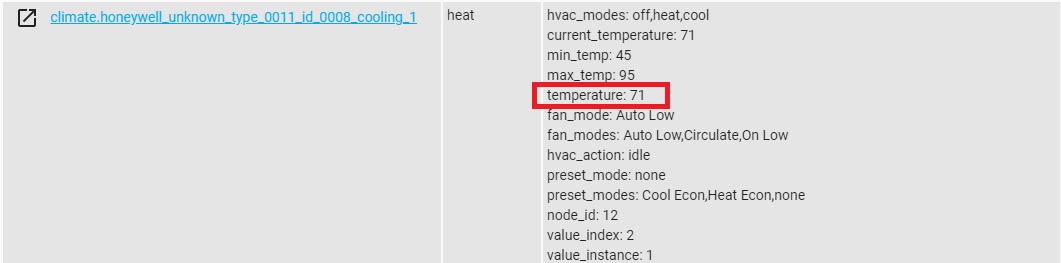

When I change the target temperature using the slider it changes the temperature: attribute of the entity climate.honeywell_unknown_type_0011_id_0008_cooling_1
Ideally, I’d have the heat mode kick in if the temp goes 2 degrees below the temperature: attribute and the cool go on if it goes 2 degrees above the temperature: attribute.
