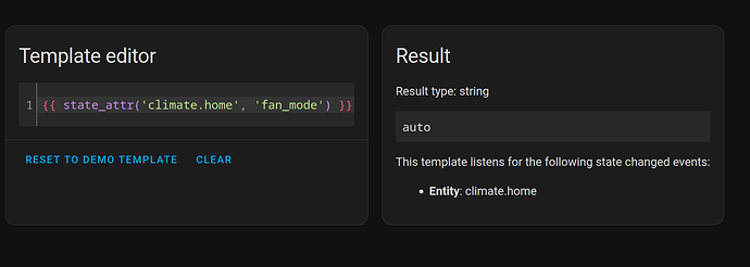

Have you tested each individual action? Does ‘on’ work and ‘auto’ fails?
Ensure you are referencing the correct fan modes by referencing the device in Developer Tools

Just tested both, neither worked. Used my phone Ecobee app to change fan mode, no change to my boolean toggle switch in HA
Resolved. Just wasn’t being patient enough. Takes about 45-75 seconds after the state change for the binary toggle to change. In triaging I did notice that the actual Ecobee app apparently doesn’t have this sync built in because often times it’s telling me the fan is on when it’s been turned off from HA. Maybe Ill ping their devs to encourage them to create a sync automation :wink:
