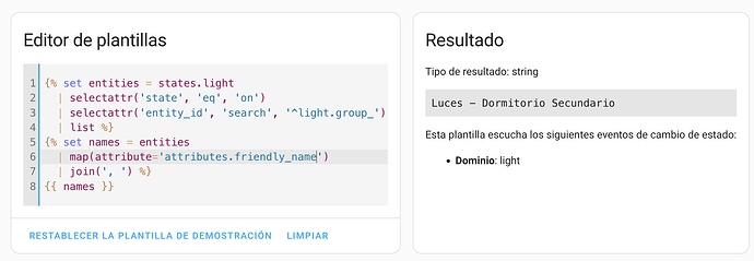

I’m trying to do an automation to execute when going out of my home to turn off turned on lights.
I want to searh for turned on lights
If there are turned on lights, notify and turn off lights.
For doing that I have defined an automation variable with turned on lights.
variables:
  turned_on_lights: >
    {{ states.light
      | selectattr('state', 'eq', 'on')
      | selectattr('entity_id',  'search', '^light.group_') | list }}
  light_names: >
    {% set names = turned_on_lights | map(attribute='friendly_name') | list %}
    {{ names }}
My problem is getting names of turned on lights to use it on the notify action. I’m trying to use the turned_on_lights variable to avoid repeting code for getting names but I have try several options but didn’t work.

I don’t understand why my code is working on template editor, but not on automation execution.
Here is my automation editor

Can you please help me doing it in the way that I’m exposing? I prefer by this way to learn and because it’s more customizable.
