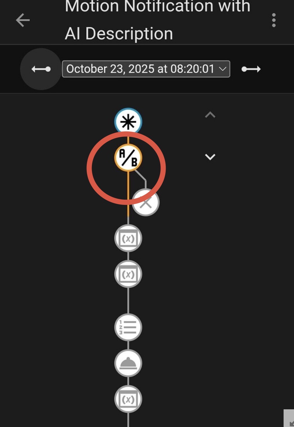

Anyway, here is the trace from this morning’s failed run. You can see it gets triggered, and passes the condition, but then stops at the very first action. This doesn’t look like I would expect “queue saturation” to present itself. (Trace JSON file follows)
Here’s the trace file. Actually in here, I can see that the current run is only 2 out of a possible 25. And this is only because I separated out the attribute condition from the trigger so it’s getting triggered once for the file getting opened, but failing the condiition, and another for it closing, which passes. The files are pretty small (a couple of megabytes) so I’d imaging the opening and closing happen in pretty rapid succession.

Honestly, I see nothing wrong with the trace, except for the fact that the flow just doesn’t run the actions. Can anyone versed in interpreting these trace files read more into this?
This is clear sign of que saturation.
The second screenshot in your most recent post doesn’t relay much doesn’t even say the automation is stoped but if you took that picture after you clicked on the most step in that trace that would be helpful to diagnose this trace.
Additionally you did not change your max que from 25. We can’t rule this out until you change this to a bigger number and not just 26.
In the trace JSON, in the hierarchy of
trace -> trace -> trigger/0 -> changed_variables -> this -> attributes
we have this:
It is clear to me that there is no queue saturation here (yet). This is the second of 25 items in the queue. In any case, it is not being run 25 times. I do think that there may be a run that is hanging, and causing the queue to start backing up. Is this what you’re talking about when you say “saturation”?
I found something interesting in my logs:
2025-10-23 08:20:31.250 WARNING (MainThread) [custom_components.llmvision.media_handlers] Timeout while waiting for ffmpeg stdout read; terminating read loop
That could explain why the automation is not completing, and why the queued instances seem to start buliding up. I don’t know why this kind of operation should timeout though. these videos are all small, less than 5 MB. FFMPEG should rip through those in a second or two, all that LLMVision is doing is pulling out key frames to send to the AI, it’s not like it’s re-encoding video. I guess I’ll raise an issue with LLMVision to see why this might happen.
I also found 3 days-old instances of ffmpeg still running, but doing nothing.
I shall continue to investigate :slight_smile:
Sorry about that, on my phone i did not see the trace file. give me a second to see
Okay @SteveDinn what i can see on my end is that the time between the file is closed and your llmvision call is within the milliseconds. Issue that might be too quick as the way nvr’s write video is by adding meta data to it at the end of the process which may be triggering llm to pull a video file that not truly ‘finished’ writing. Just a theory try adding a delay before llm vison just a 1 second delay should be fine.
If this is a poke at what I wrote earlier, read my post again. I was not suggesting to increase the queue to 26. I was suggesting to ensure the stored trace is greater than the queue by either increasing the trace to 26 or setting the queue to 4 (1 below the default trace of 5).
@SteveDinn the only thing I can suggest at this point is to investigate the HA logs. Your LLM might be throwing errors due to too many requests or whatever other reason LLMs decide to freak out.
I don’t use LLMs so can’t be very specific, but given that practically all your actions depend on your LLM to provide a response to be considered done, that would be the next logical troubleshooting step.
@ShadowFist
Sorta, what he first described matched that.
Regardless i dont think its the api for the llm itself i think its to do with the blazing speed it reads the file. For instance when i download files from the internet sometimes i cant just double click and open the file tho chrome says its done, sometimes in the folder the file actually live youll see a blank file because it not truly done writing the file. I feel thats the same thing going on here. If it were truly api rate limit i feel i would of caught that himself and say an appropriate error. And honestly if thats not the case here either then its an issue with the integration.
But to be transparent i had a similar automation that complimented anyone who walked past my front door (smart tactic to stop people from hanging around my nyc apartment) and the volume is way higher than what he probably has in his home. I never ran into this issue
