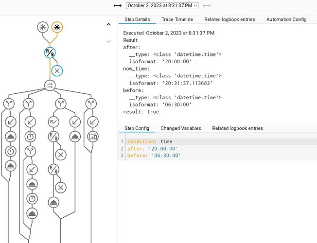

Screenshot of trace is attached

According to the trace, the condition is not met. Did you check it?

This happened again yesterday, I re-checked and confirmed that the conditions are met.
What do you see when clicking the choose step? (the double arrow)

I have exactly the same. The condition passed (as well in the automation as manually) but the actions are not performed. You can also see in the last picture of Harsha, the condition met, but the next step is just not starting for some reason.
