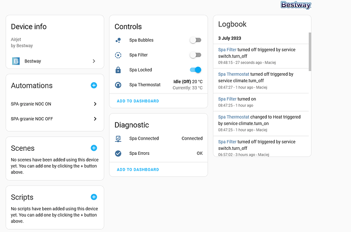

switch.sonoff_1001032177 - this is SONOFF TH16 so can on and off power and have temperature sensor - sensor.sonoff_1001032177_temperature
climate.spa_thermostat - Bestway temperature spa sensor
device_id: f0bba9a51e0f73eff2b53d25dfc82948 - Bestway temperature spa sensor.

Do you have your sensors back to front?
It’s hard to tell because you have not given them meaningful entity ids.
Are you sure you have a sensor.f0bba9a51e0f73eff2b53d25dfc82948 ? it looks like you have just used the device_id for the climate entity ?
Maybe use state_attr('climate.spa_thermostat', 'current_temperature') instead ?

Thank you very much @tom_l @Holdestmade for your help. Now it is working.
You can remove this as you don’t have that sensor
Maybe replace with:
  - platform: state
    entity_id: climate.spa_thermostat
