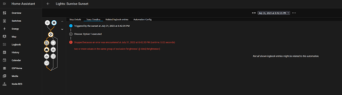

In the log book I see that the sunset even occurs, but nothing in the automation based on the sun setting even triggers. However, I may have just found the issue. In the automation trace I see the following error. I don’t have much experience reading the automation traces.
It looks like it doesn’t like having 2 brightness values.
That’s why the example I posted yesterday specifies just one brightness option (namely brightness_pct).

Thank you. I was able to resolve this. It was the dual brightness value. For testing, I wound up duplicating the automation, changing the on/off time and simply testing it several times. Thanks for everyone’s help!
