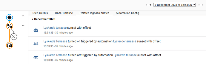

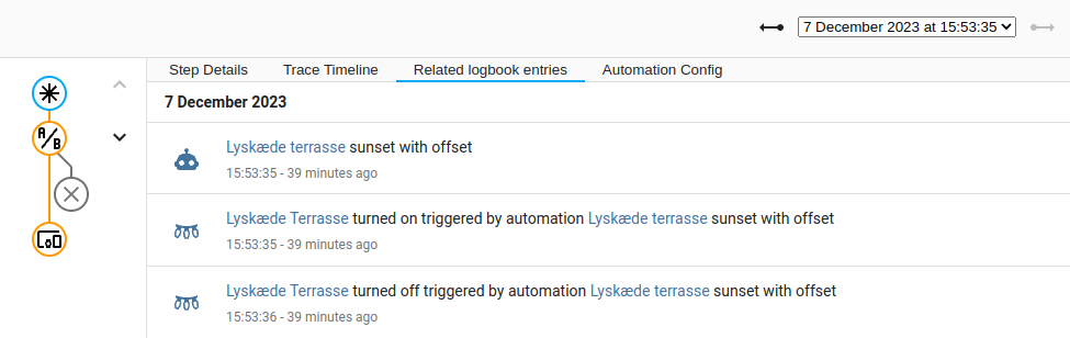

Hi. I’m going nuts. I have this automation:
alias: Lyskæde terrasse
description: ''
trigger:
- platform: sun
event: sunset
offset: '+00:15:00'
condition:
- condition: template
value_template: '{{ now().month >= 12 or now().month <= 1 }}'
enabled: true
action:
- type: turn_on
device_id: 41730f3395fd1c4d3d1292dfc38276f8
entity_id: 34e9e400eebf26b2ff80004beeaac5d8
domain: light
mode: single
The device_id is a Hue smart plug LOM001 on a Hue Bridge, integrated with the Hue integration.

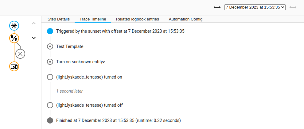

When the automation runs, I get this trace log:
For those, like me, who thinks “something else is turning them off” - the answer is no. It’s done by above automation, at least according to the logs:
I can’t for the life of me figure out why it behaves that way. What am I missing?

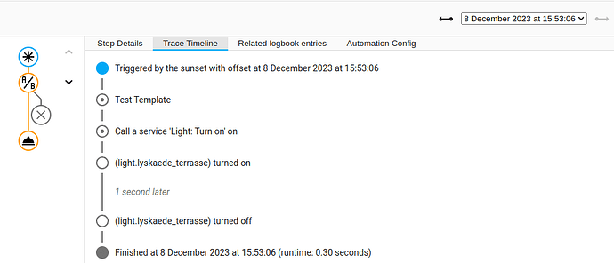

Thanks for the suggestion. I changed the automation to this:
description: ''
trigger:
- platform: sun
event: sunset
offset: '+00:15:00'
condition:
enabled: true
action:
- service: light.turn_on
entity_id: light.lyskaede_terrasse
mode: single
The results are not as great as I had hoped for:
Troon
(Troon)
December 8, 2023, 3:09pm
4
Can you successfully control that light directly from the frontend?

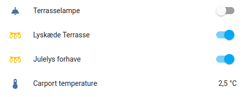

You can see it as the second one on the card below (sorry about the Danish names):

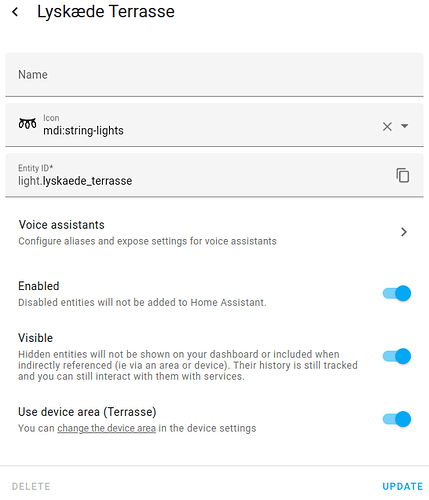

And just to show you the ID of that entity:

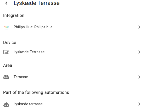

Have a look under … / Related, like this:
Are there any other automations or scripts showing that interact with your light?
ljorg
December 8, 2023, 3:21pm
8
No, only the one not working correctly:
