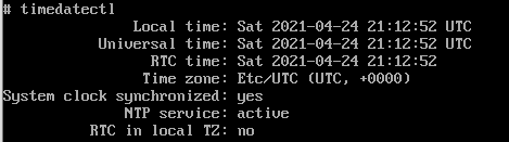

Plant Status -
System time -
time
Sadly it still won’t trigger. If I trigger the automation manually the push over and Alexa notification work fine
