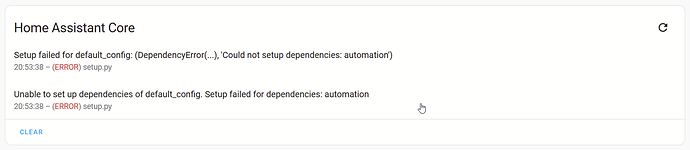

These notifications appeared after the machine restart.
rename automations.yaml to automations.old
create an empty automations.yaml
restart HA
copy one for one an automation from automations.old to automations.yaml, reload automations, until you find the faulty automation
Before I go through all that, they all stopped working on their own, I mean, I didn’t add or change any automations. Most, if not all the automations need the associated device changed since I had to reprogram my entire zwave controller. Would that be the cause of the problem? Before they just were missing the associated device; that was what I was going to fix and re-add.
This happens if you use device automations, and the device does not exists any more.
Ahhh… crap.
