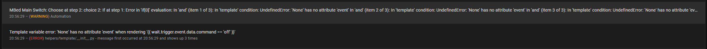

I am however getting this in the logs when I click the on button on RODRET switch, off seems to be working, this is what seems to be turning off automation.
Log details (WARNING)
Logger: homeassistant.components.automation.mbed_main_switch
Source: helpers/script.py:2064
integration: Automation ([documentation](https://www.home-assistant.io/integrations/automation), [issues](https://github.com/home-assistant/core/issues?q=is%3Aissue+is%3Aopen+label%3A%22integration%3A+automation%22))
First occurred: 21:16:41 (1 occurrence)
Last logged: 21:16:41
MBed Main Switch: Choose at step 2: choice 2: If at step 1: Error in 'if[0]' evaluation: In 'and' (item 1 of 3): In 'template' condition: UndefinedError: 'None' has no attribute 'event' In 'and' (item 2 of 3): In 'template' condition: UndefinedError: 'None' has no attribute 'event' In 'and' (item 3 of 3): In 'template' condition: UndefinedError: 'None' has no attribute 'event'
Log details (ERROR)
Logger: homeassistant.helpers.template
Source: helpers/template/__init__.py:1750
First occurred: 21:16:41 (3 occurrences)
Template variable error: 'None' has no attribute 'event' when rendering '{{ wait.trigger.event.data.command == 'off' }}'
Template variable error: 'None' has no attribute 'event' when rendering '{{ wait.trigger.event.data.cluster_id == 6 }}'
Template variable error: 'None' has no attribute 'event' when rendering '{{ wait.trigger.event.data.endpoint_id == 1 }}'```

The logs are
Log details (ERROR)

The logs are
Log details (ERROR)
