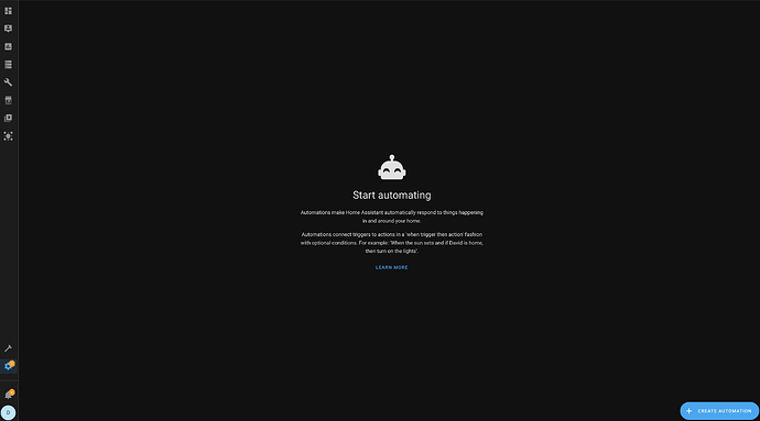

Updated and went for a walk, upon returning home none of my automations were working. Have fully restarted to no avail and I can’t really understand the logs.

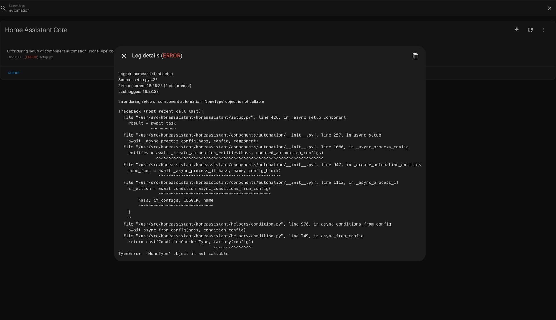

What do the logs say ?
Logger: homeassistant.setup
Source: setup.py:426
First occurred: 18:28:38 (1 occurrence)
Last logged: 18:28:38
Error during setup of component automation: ‘NoneType’ object is not callable
File “/usr/src/homeassistant/homeassistant/setup.py”, line 426, in _async_setup_component
result = await task
File “/usr/src/homeassistant/homeassistant/components/automation/init.py”, line 257, in async_setup
await _async_process_config(hass, config, component)
File “/usr/src/homeassistant/homeassistant/components/automation/init.py”, line 1066, in _async_process_config
entities = await _create_automation_entities(hass, updated_automation_configs)
File “/usr/src/homeassistant/homeassistant/components/automation/init.py”, line 947, in _create_automation_entities
cond_func = await _async_process_if(hass, name, config_block)
File “/usr/src/homeassistant/homeassistant/components/automation/init.py”, line 1112, in _async_process_if
if_action = await condition.async_conditions_from_config(
hass, if_configs, LOGGER, name
File “/usr/src/homeassistant/homeassistant/helpers/condition.py”, line 978, in async_conditions_from_config
await async_from_config(hass, condition_config)
File “/usr/src/homeassistant/homeassistant/helpers/condition.py”, line 249, in async_from_config
return cast(ConditionCheckerType, factory(config))
TypeError: ‘NoneType’ object is not callable

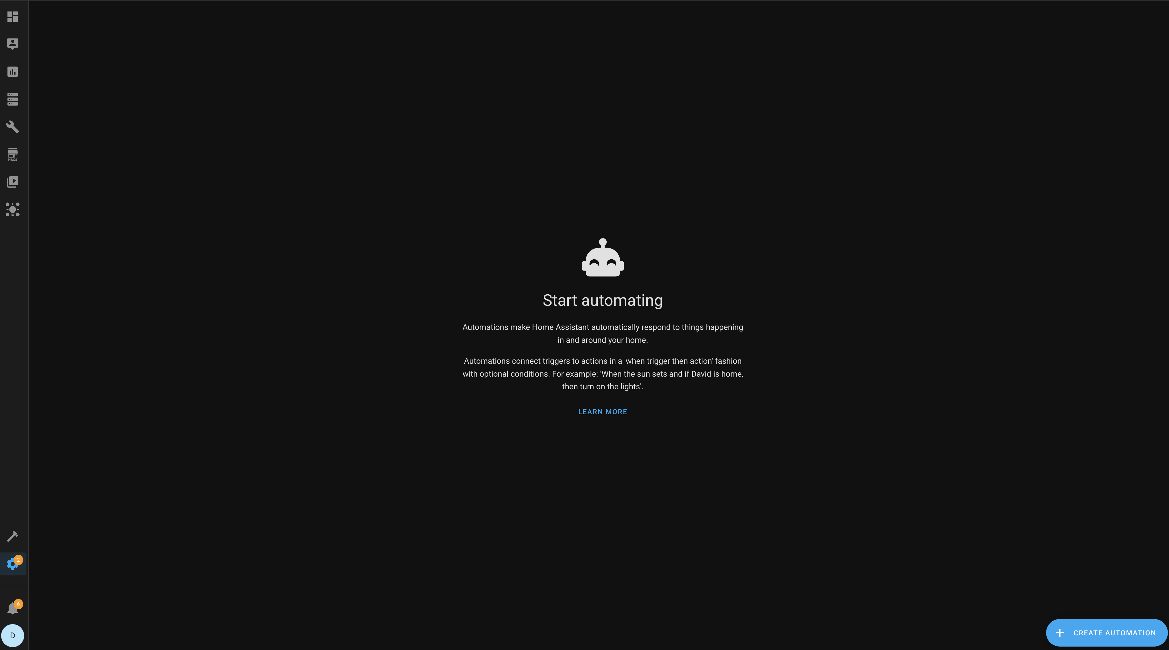

Same problem here (after update ‘Entity Progress Card Update 1.47 > 1.48)
Not sure if that update had something todo with it, at that moment I see my automatizations where completely gone and after reading this problem solving I thought OMG … NO WAY … ALL THAT WORK HAVING TODO !!!
