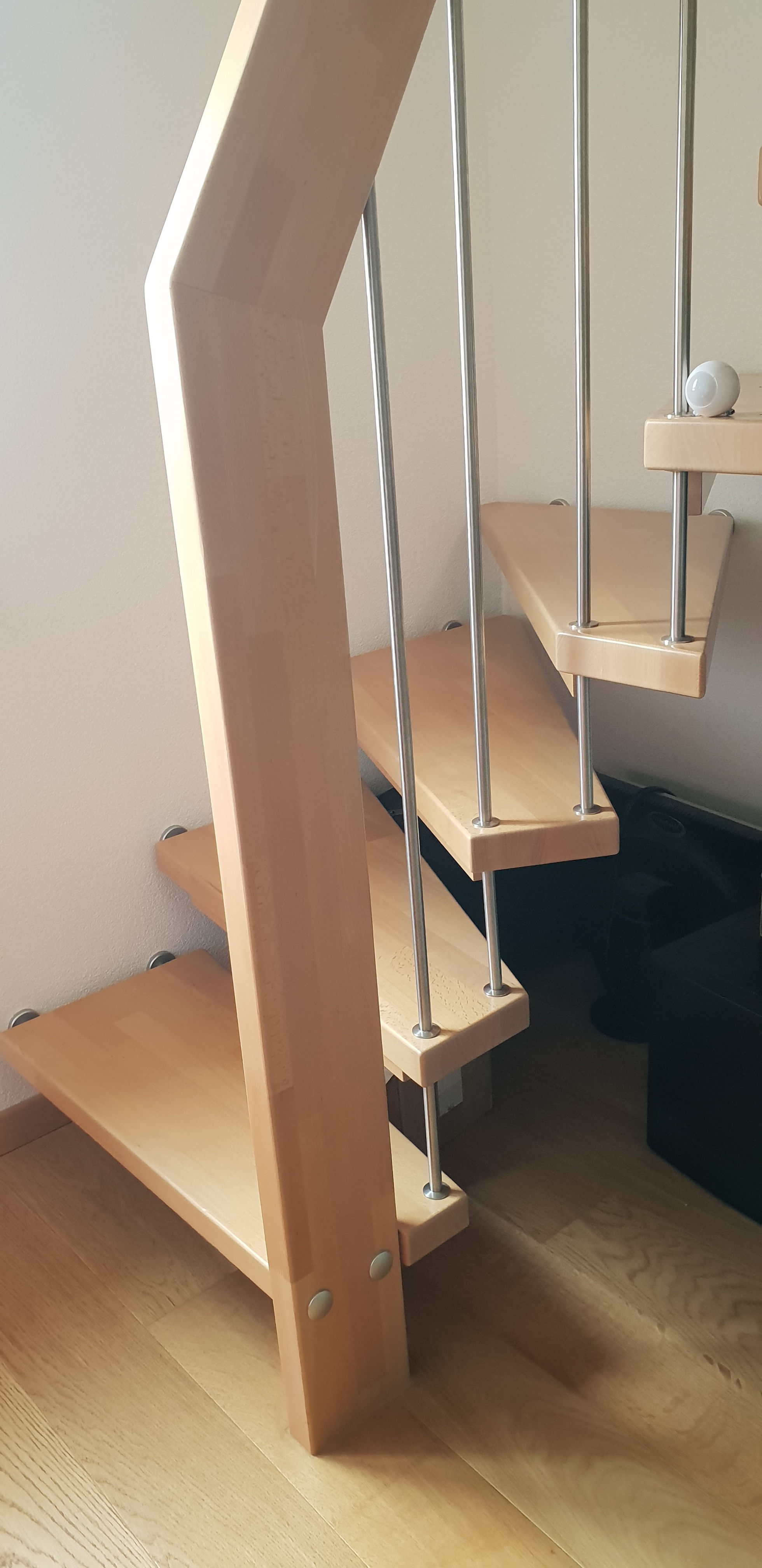

So why all these experiments? We are currently in the process of building a 3-story house and the 2 upper floors will be connected by open-string stairs (see example picture below). Since I want to be able to measure temperature, motion, etc. in almost every room and thus equip them with Fibaro motion sensors anyway, I thought it would be interesting to push this concept a little further. So how about taking into consideration “vibrations” in automations?

My initial use case: light automation triggered by vibrations on stairs
In this example, my open-string stairs will connect the first floor with the second floor. How would you build an intelligent light automation that switches on the light in the destination corridor as soon as somebody uses the stairs to go up or down, whilst turning off lights in the corridor you came from?
Here’s the code that I put together in order to illustrate the logic behind my approach. Two main thoughts:
  1. If you go upstairs, then the motion sensor will have detected you before you step on the stairs and create any vibration. Conclusion: you you up!
  2. If you go downstairs, the motion sensor will not have detected anything before you step on the stairs and create any vibration. Conclusion: you go downstairs!
You can now use this information in order to add other conditions (luminosity, night/day, etc.) and actions (light on/off, heating on/off, etc.)
