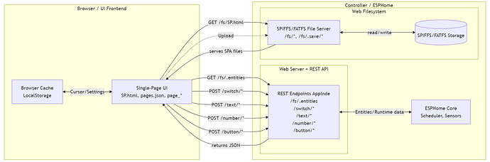

My solution was to integrate a lightweight file server on the controller
and deliver the UI as a reactive Single Page Application. That keeps updates small
and allows them to be rolled out independently from the firmware.

The “UI magic” happens in the browser via JavaScript. As the reactive framework I use Alpine.js. It needs very little memory and can be hosted by the controller.

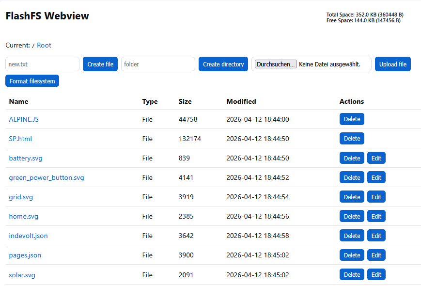

Here you can see the interface of the web file system

no, that assumption is incorrect; the file server runs on ESPHome.
