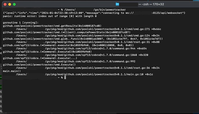

Hey @poolski, I have tried using this tool to export some of my energy data but I am getting a runtime error. This happens on my MacBook and a windows machine.
Any ideas? I have a screenshot below with my personal information removed.
I’ve just realised something… I’ve based the code specifically on my sensor name.
I’ll need to have a look at it and make the power consumption sensor configurable, because yours will be different and it’ll throw an error.
Thanks for pointing this out - I’ll post a fix soon.
