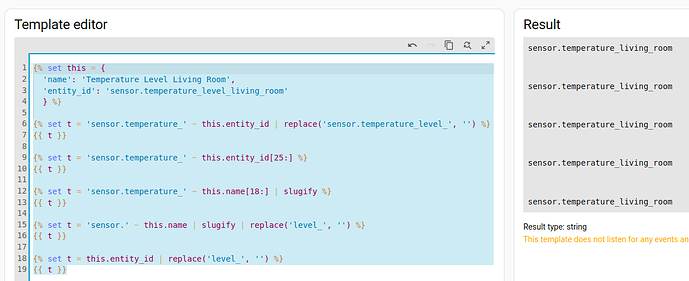

Here are several ways to extract strings for your application. Most use this.entity_id because it’s best for your specific application. However, I included two that use this.name to demonstrate that it’s not all that more difficult, even for this situation.
Click to reveal code
{% set this = {
  'name': 'Temperature Level Living Room',
  'entity_id': 'sensor.temperature_level_living_room'
{% set t = 'sensor.temperature_' ~ this.entity_id | replace('sensor.temperature_level_', '') %}
{{ t }}
{% set t = 'sensor.temperature_' ~ this.entity_id[25:] %}
{{ t }}
{% set t = 'sensor.temperature_' ~ this.name[18:] | slugify %}
{{ t }}
{% set t = 'sensor.' ~ this.name | slugify | replace('level_', '') %}
{{ t }}
{% set t = this.entity_id | replace('level_', '') %}
{{ t }}

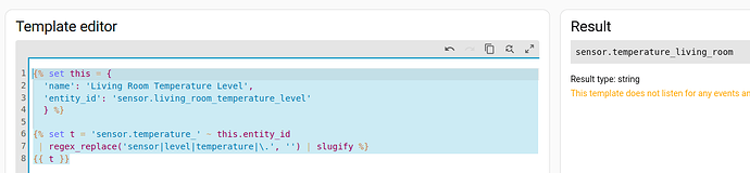

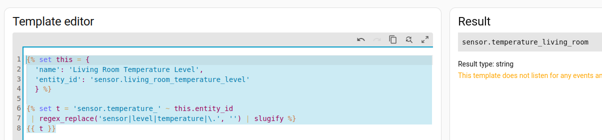

Just in case the order of the words temperature, level and the room’s name can vary, this example attempts to handle that situation.
{% set this = {
  'name': 'Living Room Temperature Level',
  'entity_id': 'sensor.living_room_temperature_level'
 | regex_replace('sensor|level|temperature|\.', '') | slugify %}
{{ t }}

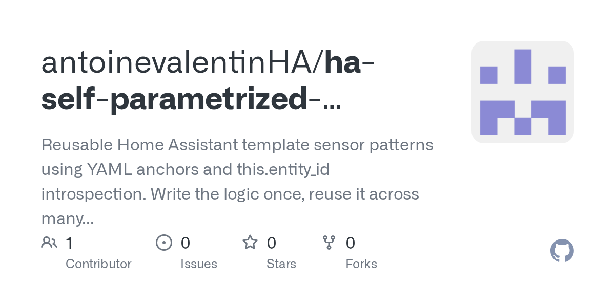

Since the original post I’ve pushed the pattern a bit further and built a full
self-parameterized sensor pipeline.
The idea is still the same:
this.entity_id → derive suffix → derive dependencies
But the pattern can also scale to multi-stage sensors.
Example:
temperature_min_daily_room_X
temperature_max_daily_room_X
temperature_minmax_daily_room_X
color_temperature_min_daily_room_X
color_temperature_max_daily_room_X
color_temperature_minmax_daily_room_X
Each stage is generic and derives its sources from its own this.entity_id.
Adding a new room requires no changes to the template logic.
I added a full working example here:
