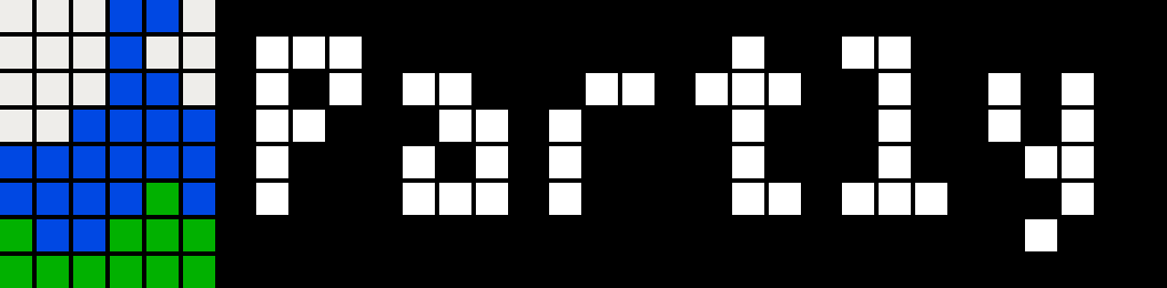

Just published a few flows.
BOM Australia Weather Report
https://flows.blueforcer.de/flow/PjqG5X8V5YNK
A/C Climate Control and Door Notification
https://flows.blueforcer.de/flow/np78OpdZOGKm
