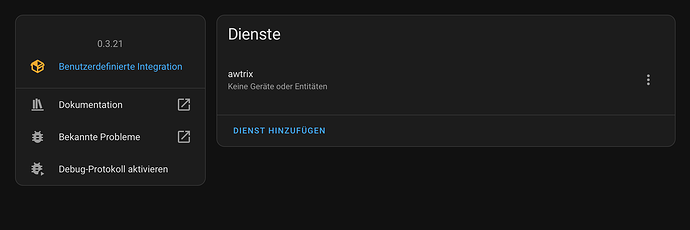

I’m a bit lost with my awtrix.
I switched from ioBroker to Home Assistant. I have an external MQTT Broker running, the Awtrix3 device is publishing on it, the HA discovery is on. In HA I can not find the device with this integration neither I can configure anything like MQTT server or something like that. There seems to be no configuration in the integration, is that right? Could u guys help me. That would be wonderful! Thanks.
yes. this right.
