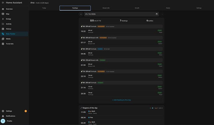

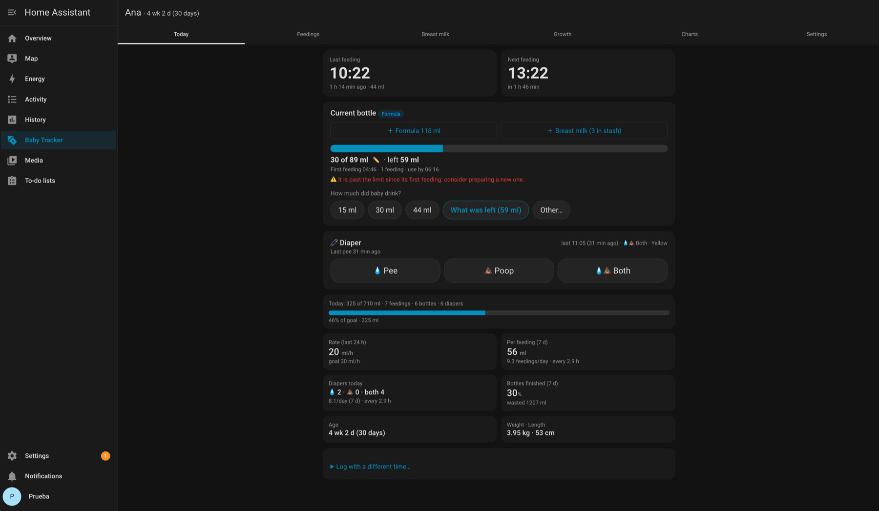

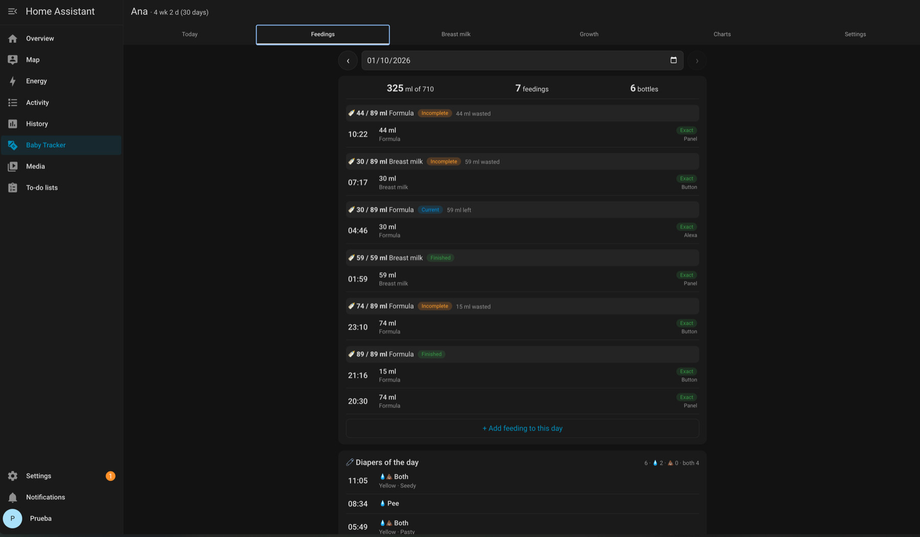

  • Bottles + incremental feedings. Each feeding adds to the current bottle, so “1 oz now, 1.5 oz later” lands in the same bottle. You start a new bottle only when you actually prepare one, and anything over the bottle size moves to the next bottle automatically. It tracks amount per feeding, feedings per day, % of bottles finished and wasted formula.

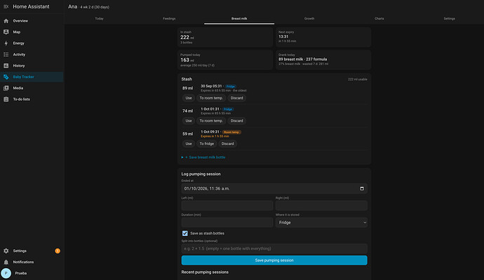

  • Breast milk. Pumping sessions (left/right) go into a stash with expiry (fridge or room temperature). When you give breast milk, you pick the stash bottle you used and it’s deducted. A formula bottle can be paused while the baby has breast milk first, then resumed.
  • Diapers. Pee, poop or both, with color and consistency (your baby’s “usual” is preselected).
  • Pediatrician’s plan. Amount per feeding and interval set the daily goal and when the reminder fires.

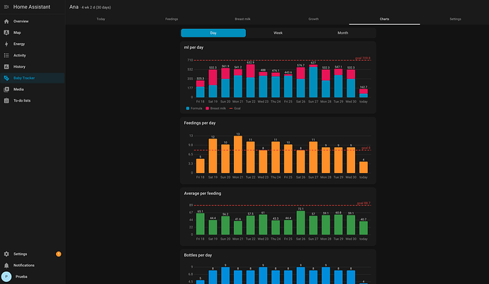

  • Charts by day, week or month, including when the baby usually eats and needs a change.
