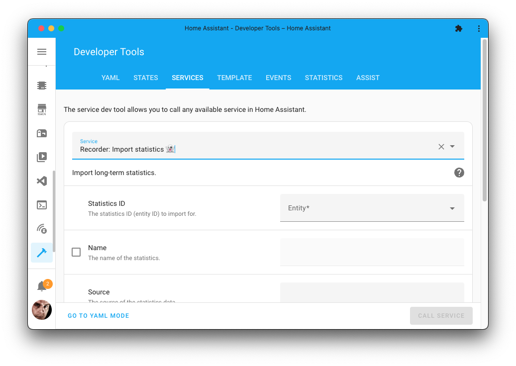

Somewhat related @frenck has a new custom integration of "things/features, that will never end up in Home Assistant itself", as part of that there is a service recorder.import_statistics:
The description in the README.md is only "Advanced service to directly inject historical statistics data into the recorder long-term stats database."
Without installing it to see the dialog from Developer tools -> Services, the services.yaml gives some clues about parameters and how to use it:

The code looks very straightforward/minimal and uses the recorder integration so it should be database agnostic.
There is this community thread for the Spook integration, but so far no clarifying details usage of import statistics:
For anyone else stumbling on this thread, here is the documentation for doing it with spook:
