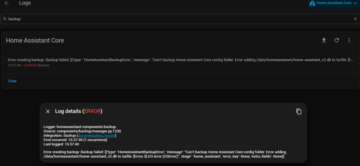

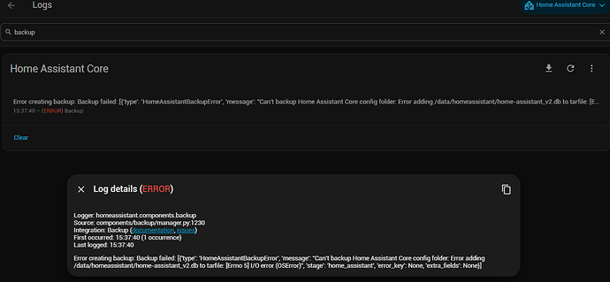

error:
Logger: homeassistant.components.backup
Source: components/backup/manager.py:1230
Integration: Backup (documentation, issues)
First occurred: 18:17:29 (1 occurrence)
Last logged: 18:17:29
Error creating backup: Backup failed: [{'type': 'HomeAssistantBackupError', 'message': "Can't backup Home Assistant Core config folder: Error adding /data/homeassistant/home-assistant_v2.db to tarfile: [Errno 5] I/O error (OSError)", 'stage': 'home_assistant', 'error_key': None, 'extra_fields': None}]

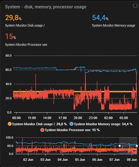

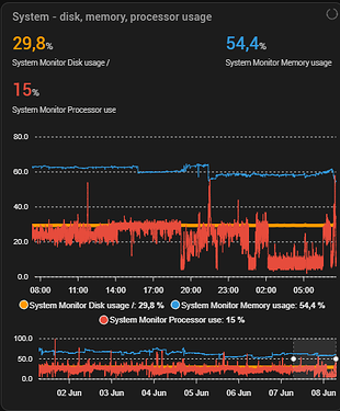

As an aside I thought maybe that the system is overloading originally, but after trying a number of backups it seems it is ok from what I understand in terms of disk, memory and processor - i think some of the processor spikes are when the automatic backups and now most recently manual backups have been manually triggered by me - system should run automatically at like 5:00 but these do not always seem to be seen in the processor:

I tried again an automatic backup as the manual with only HA settings worked but it was still not going, I tried manual again including history and it failed.
I would really hate to lose all my history if something should go haywire - any ideas? My guess now is that something in history has gone bad (?) or a process locking up the database (?) but I am really not sure how I would figure this out and hopefully fix it?
