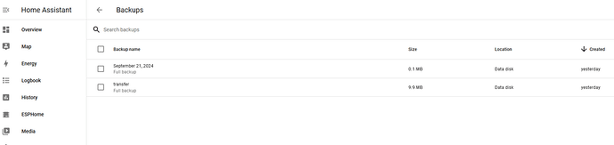

There is no restore option, until the file is uploaded. When I try to upload the tar file, that is when I get the incorrect extension .tar error. I believe this is some kind of bug.
Pictures included in case someone wants to look into it.
