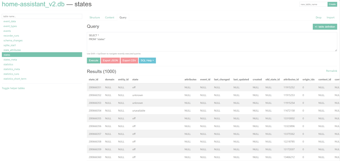

However, I must be doing something else incorrectly because the entity_id is not being recorded. See the screenshot from SQLite below.

Any suggestions?
tom_l
4
The database schema has changed since that was written, so the SQL queries are out of date. There are some updated ones here:
