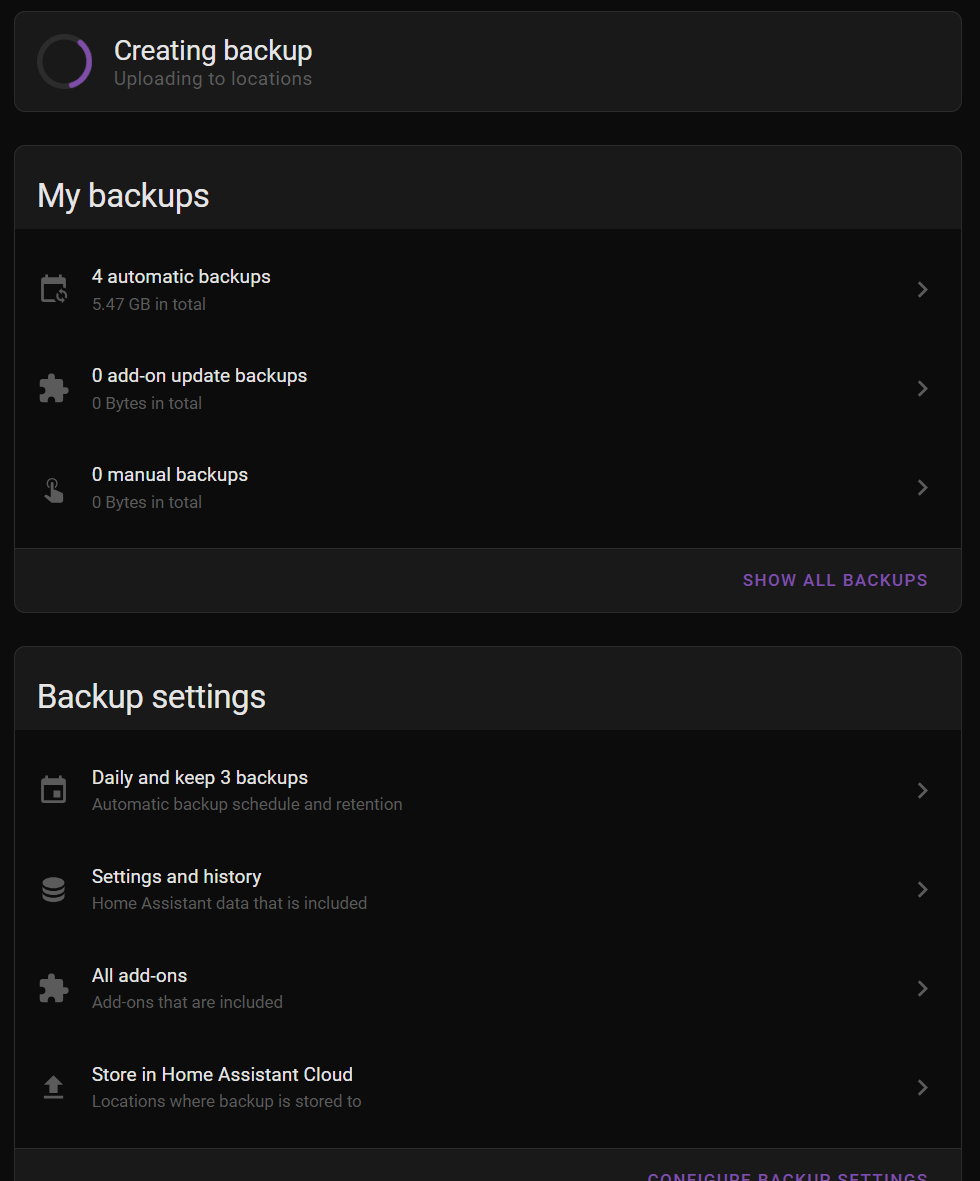

Backup stuck, no way to restart?
This has been stuck like this for 2 days now.
I thought I’d leave it and see what happens but it hasn’t shifted

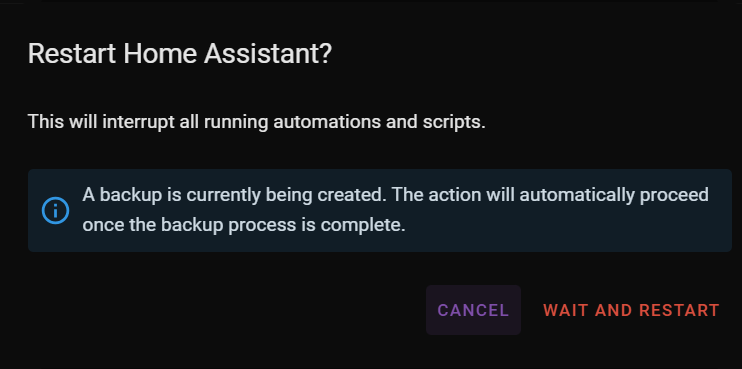

So went to restart and it won’t let me until the backup finishes (which I’m confident isn’t going to happen!)
It also won’t let me reboot
So, how the hell do I get out of this backup cycle and kill that process?
I can understand checking that this is what you want to do, but actively preventing a reboot because an upload is stuck is not logical
Have you tried refreshing the browser cache? CTRL-F5 should do it.
Yeah, that didn’t work. Eventually got it to restart through the terminal, but you really should be able to a) cancel a backup and b) force a restart through the UI

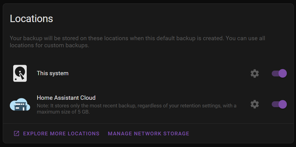

My backups are saved locally and to GoogleDrive.

For me it always happened, when my network backup location ran out of storage (my router has an option to create a SMB share from a plugged in USB drive, which I used as external backup location because Home Assistant can’t handle my NAS being shut down over night).

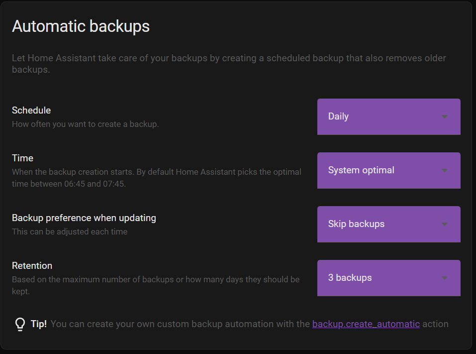

For me the initial issue was resolved by setting backup retention to a much lower number.
