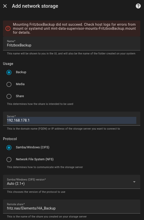

Goodevening everybody,
I’ve been trying to get the Fritz.box NAS to work all evening but I just keep getting an error saying it failed to mount. This seems related to this topic.
In the logs I get the following errors:
2026-02-04 21:23:00.382 homeassistant systemd[1]: Mounting Supervisor cifs mount: FritzboxBackup...
2026-02-04 21:23:00.406 homeassistant kernel: CIFS: Attempting to mount //192.168.178.1/fritz.nas/Elements/HA_Backup
2026-02-04 21:23:00.412 homeassistant mount[4092]: mount error(2): No such file or directory
2026-02-04 21:23:00.412 homeassistant mount[4092]: Refer to the mount.cifs(8) manual page (e.g. man mount.cifs) and kernel log messages (dmesg)
2026-02-04 21:23:00.413 homeassistant kernel: CIFS: VFS: cifs_mount failed w/return code = -2
2026-02-04 21:23:00.414 homeassistant systemd[1]: mnt-data-supervisor-mounts-FritzboxBackup.mount: Mount process exited, code=exited, status=32/n/a
2026-02-04 21:23:00.414 homeassistant systemd[1]: mnt-data-supervisor-mounts-FritzboxBackup.mount: Failed with result 'exit-code'.
2026-02-04 21:23:00.415 homeassistant systemd[1]: Failed to mount Supervisor cifs mount: FritzboxBackup.
It seems, it can’t find the folders.
The user has full acces to the NAS but no acces to the rest of the fritzbox settings.
This is the filepath when looking at the NAS in the browser.
Screenshot from 2026-02-04 22-27-56
The only thing I can think of is that the fritzbox tools integration might be interfering since its using a separate user login. But this seems inlogical.
Does anybody have a clue on where to look further to get this thing to work?
I found the error.
I was using the wrong remote share name.
For anyone else looking for an easy way to find the remote share on Linux.
Open up your fileexplorer program, navigate to the network disk.
Then you can use the filepath at the top or the properties menu of the folder you want to acces to find the remote share.
Remove the fritz.box part of the filepath since thats being taken care of by the IP adress and everything should work.
