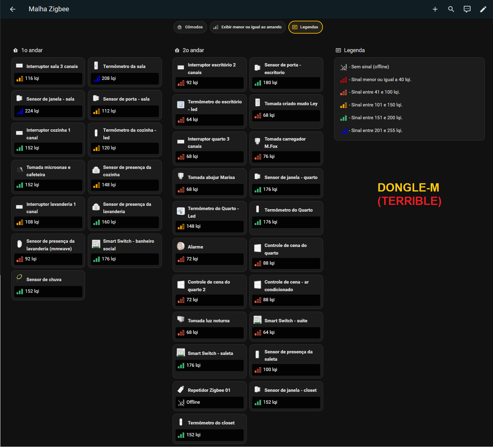

I have a network with almost 40 Zigbee devices.

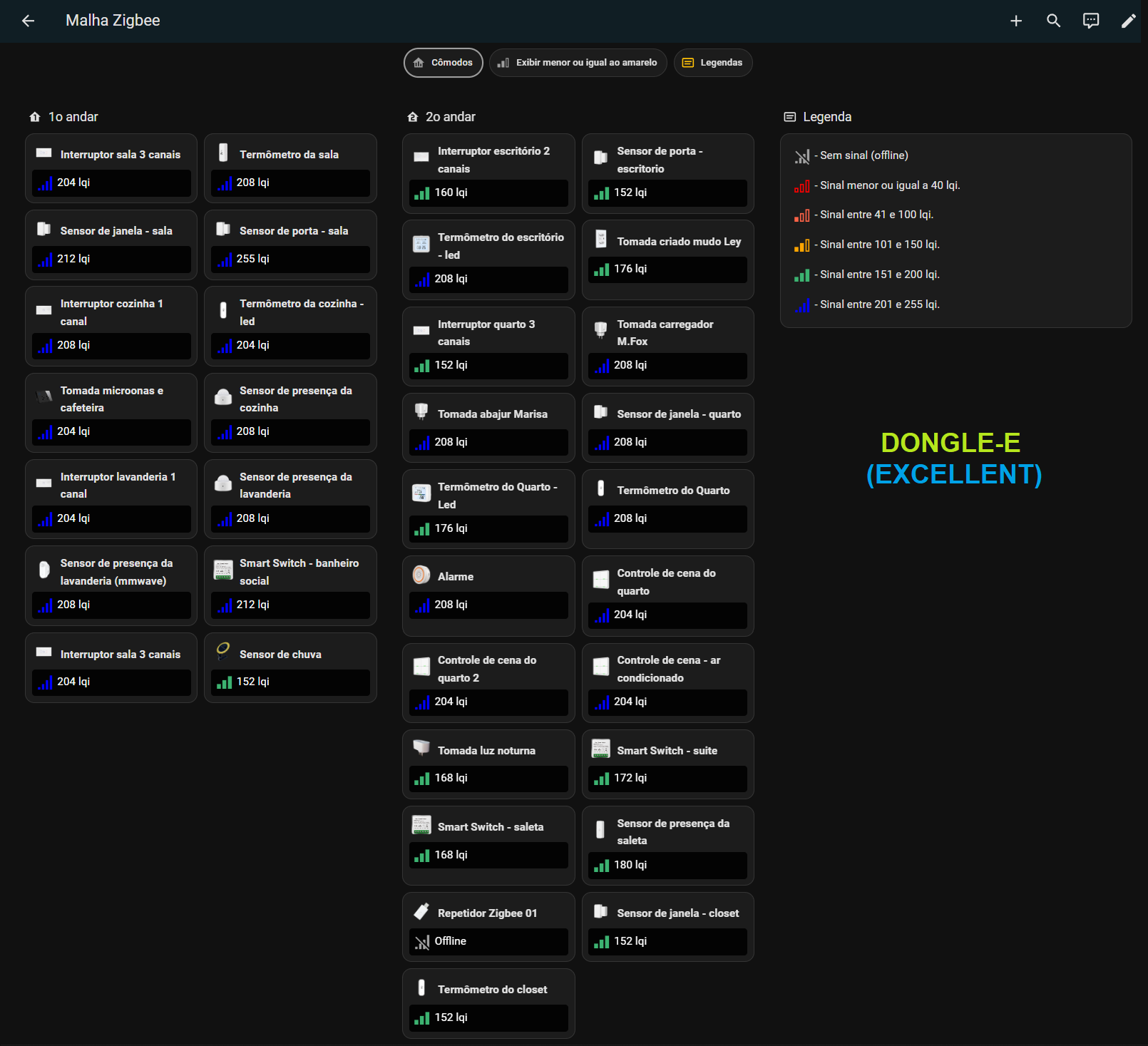

I used a Sonoff Dongle-E + Zigbee2MQTT and, in general, the network performance was very good. Rarely did any device drop below 150 lqi.
I bought a Sonoff Dongle-Max believing it would improve performance, as some annoying glitches occasionally occurred.
However, the opposite happened. The lqi quality of all devices dropped significantly! They all drop below 150 lqi and many are now below 70 lqi, which was unthinkable with the Dongle-E.
I’ve already connected the Dongle-M directly to the USB, I’ve connected it via TCP, I’ve repaired the devices, and nothing has improved the network quality, and I have no idea why this is happening!
Theoretically, the Dongle Max should be better than the Dongle-E, but in practice it’s the opposite. My hardware is as follows:

I had the same issues.
My setup is basically the same as yours. Never had any signal issues with my Dongle - E.
I tried to use the dongle max for a day but I just couldn’t handle it.
Another issue that I had is that devices would disconnect from the network and never reconnect… So I would need to keep repairing them.
Switched back to my dongle e and all of these issues vanished.

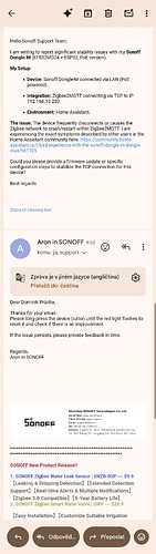

I wrote to Sonoff technical support where they told me the following…

No reset didn’t help here is another answer from support:Dear Dominik Průcha,
Thanks for your shairng.
The screenshot you provided shows the device is not connected to the internet. Please check whether the device is experiencing difficulties registering with the router or if it intermittently goes offline or disappears from the router’s settings.
According to our current investigation, LQI values obtained by different chip models under the same conditions may vary and cannot be directly compared. We have also confirmed with the manufacturer that the Dongle-PMG24 and Dongle-LMG21 use different methods for measuring LQI. Therefore, we suggest you check whether this has a substantial impact on network stability.
The firmware version V1.0.5 has recently been released; you can try it to see if it improves the situation.
Thanks for your time!
Regards,
Aron in SONOFF
