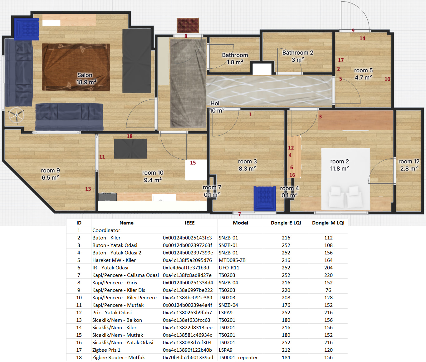

Hi everyone,
After following this thread for a while, I wanted to share my own experience.
Unfortunately, the Sonoff Dongle-M has not met my expectations so far. I’m not saying it is a bad coordinator, but compared to my previous Dongle-E, the experience has been noticeably worse in my environment.
Hardware
Previous coordinator
  • Sonoff Dongle-E - EFR32MG21
New coordinator
  • Sonoff Dongle-M:
    EFR32MG24 Firmware: Stable V1.0.0 (SDK 7.4.5)
    ESP32-D0WDR2-V3 Firmware: Stable V1.0.10
Both coordinators were used with Zigbee2MQTT (Ember adapter).
Network
  • ~20 Zigbee devices
  • Routers and battery-powered devices
  • Same house
  • Same coordinator location
  • Same USB extension cable
  • Same Zigbee channel
  • Same router locations
  • Same end devices
The coordinator is the only hardware change.
What I observed
Compared to the Dongle-E, I experienced:
  • Noticeably lower LQI values across many devices.
  • Devices choosing unexpected parents.
  • Some battery-powered devices taking much longer to pair.
  • Temporary Interview failed states that sometimes recovered by themselves.
  • Devices occasionally appearing in Home Assistant later than expected.
  • Initial network formation taking significantly longer.
  • Some battery devices becoming unavailable or requiring re-pairing during testing.
I understand that LQI alone is not an indicator of network quality, and I’ve read many comments saying it should not be compared directly between coordinators.
However, even ignoring the LQI values, I still experienced practical issues such as delayed pairing, interview problems, and devices occasionally dropping from the network. Those are the issues that concern me the most.
Troubleshooting performed
To rule out migration-related issues, I eventually rebuilt the entire Zigbee network.
Steps:
  • deleted database.db
  • deleted coordinator_backup.json
  • generated a new PAN ID
  • generated a new Extended PAN ID
  • generated a new Network Key
  • stopped using the previous coordinator IEEE and switched to the Dongle-M hardware EUI64
The clean rebuild is behaving a little bit better than the migrated network, but I’m still rebuilding the mesh and monitoring stability.
Data I’ll provide
To keep this discussion objective, I’ll also post:
  • complete Zigbee device list
  • old vs. new LQI values for every device
  • house floor plan showing coordinator, routers and end devices
  • topology graph
Hopefully this information will help determine whether what I’m seeing is expected behaviour, a firmware issue, or something specific to my setup.

ZHA or Z2M?
In my experience using the Dongle M, I still am fighting daily with device drop outs etc. but I have around 150 devices on my network. I do have a high number of dedicated repeaters and a high ratio of routers in the form of mains powered ZigBee devices such as lights.
Do try to use AI to analyse debug logs as it helped me to a degree.
I honestly gave up on trying to use it. It was just a waste of money.
I tried to give it another chance by waiting for updates but it never really fixed the main issue of devices randomly getting disconnected.
In this thread sonoff team explained why it will show a lower LQI per devices, but they never explained the disconnects or devices just taking forever to pair.
I’m not having disconnection issue with about 30 devices connected and 3 dongle max as router. I don’t know maybe is just an issue with more devices.
Hi, are there any updates regarding the implementation of this feature? Several months have passed and the latest available version is still 1.0.10. Thank you
I got 69 devices and I´ve had literally zero issues since I bought my Dongle-M almost half a year ago.
Glad it works for you. I have the Dongle Plus - E & all my instability problems started when I switched to the Dongle M, the opposite of what I expected. :frowning:
I’m using a Dongle-M (Max) as a Thread border router with OpenThread on HA. It seems to be performing just fine and signal levels appear solid. I know this post is about the -M as a Zigbee coordinator but just wanted to post my experience with it running the Thread firmware.
