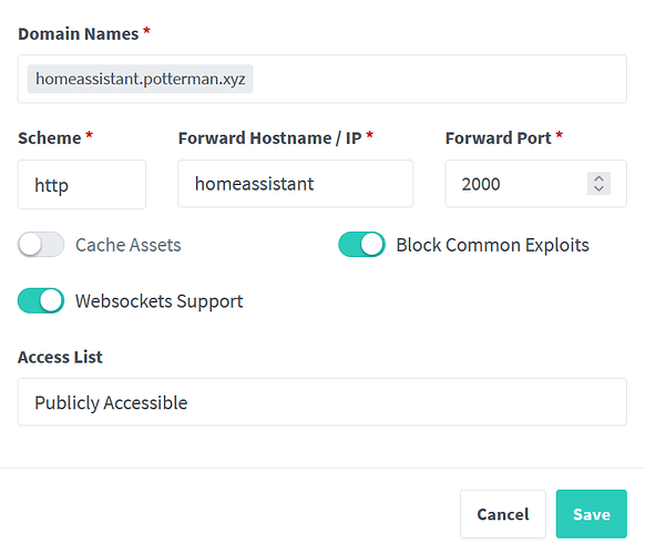

And a config for a domain inside nginx proxy manager:
The domain for the proxy manager works completely fine though, I can’t seem to find anything different in my config when it comes to HA.
I’m not sure what to try next
Well your Home Assistant config doesn’t show that you are listening on port 2000? Are you? Because it should be 8123 in NPM if you haven’t specifically told HA to listen on port 2000
And the same applies to the docker config for Home Assistant too. You are mapping 2000 external to 2000 internal, but Home Assistant isn’t listening on port 2000 unless you tell it to in the config.
Edit additionally, I would recommend allowing Home Assistant access to the host network, otherwise a lot of auto discovery stuff probably isn’t going to work.
I added the port in the HA config, its now working as intended.
