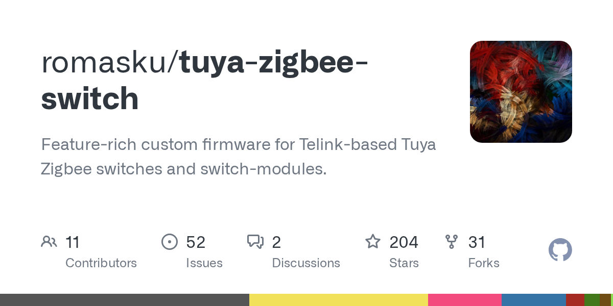

I got a suggestion from an other thread: flash a custom firmware from here
This device is compatible and now it works!
I have a detached mode push button with press, release and long press; a relay and also a led!
Thanks @ferbulous
Btw, can it still work as router if you enable that in the firmware?
For most devices there are two firmwares so you can chose between Router and End Device.
