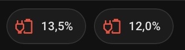

I have the Fonske Marstek modbus TCP/IP running for my home batteries.
In top of the screen there are 2 badges which show the level of the batteries.
Red/Orange/green.
Is it possible to change the color red into purple and orange into yellow?
Thx in advance!

I uses the mushroom theme/cards and cardmod integration from HACS. Please look at my code for the shower temp and try to implement for your icons. Or am I misunderstanding you, and you just want to swap the existing colours? What is the code of your badges? Normally you are able to change the colors, as you want.
Good luck. :wink:
type: custom:mushroom-template-badge
content: "{{ states('sensor.speicher_temperature') }}°C"
icon: mdi:shower-head
color: |-
  {% set temp = states('sensor.speicher_temperature') | float %}
    {% if temp < 38 %}
      blue
    {% elif temp < 42 %}
      orange
    {% else %}
      red
    {% endif %}
entity: sensor.speicher_temperature
area: hausanschlussraum
Thanks a lot guys. It worked for me. Here is my yaml for my solution
type: custom:mushroom-template-badge content: "{{ states('sensor.marstek_m1_battery_state_of_charge') }}" icon: mdi:power-plug-battery-outline color: |- {% set battery = states('sensor.marstek_m1_battery_state_of_charge') | float %} {% if battery < 30 %} Purple {% elif battery < 80 %} Lime {% else %} Green {% endif %} entity: sensor.marstek_m1_battery_state_of_charge area: garage
