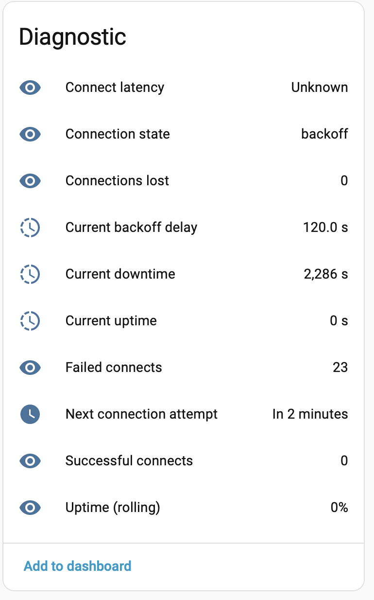

Results after 14.75 hours:

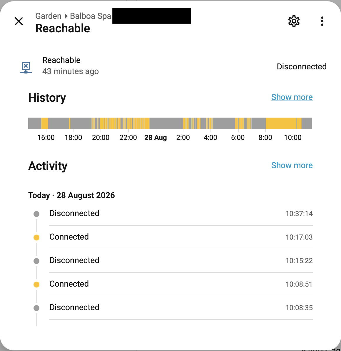

- Effective uptime: 33.85% — the module is unreachable two-thirds of the time
- 41 of 42 disconnects were “stale sockets” — the module accepts TCP, streams ~30 s of data, then goes silent without closing. TCP-level, the connection is still “up.” No data ever arrives again.
- Peak silent window: 104 minutes (overnight, at 05:17)
- Not a Wi-Fi problem. Not a channel problem. The module’s firmware just… stops.
This is why the stock integration struggles: pybalboa reads from a zombie socket, waits for a message that will never come, and hangs. Multiply by a few hours of unattended operation and you get memory pressure and, occasionally, an HA restart.

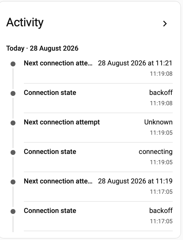

- Heartbeat / staleness detection — the spa streams ~1 msg/s; silence beyond
stale_after(default 30 s) means the link is dead, kill it and reconnect - Zombie-socket rejection — TCP SYN-ACK without spa data within the connect timeout is treated as a failure, not a success

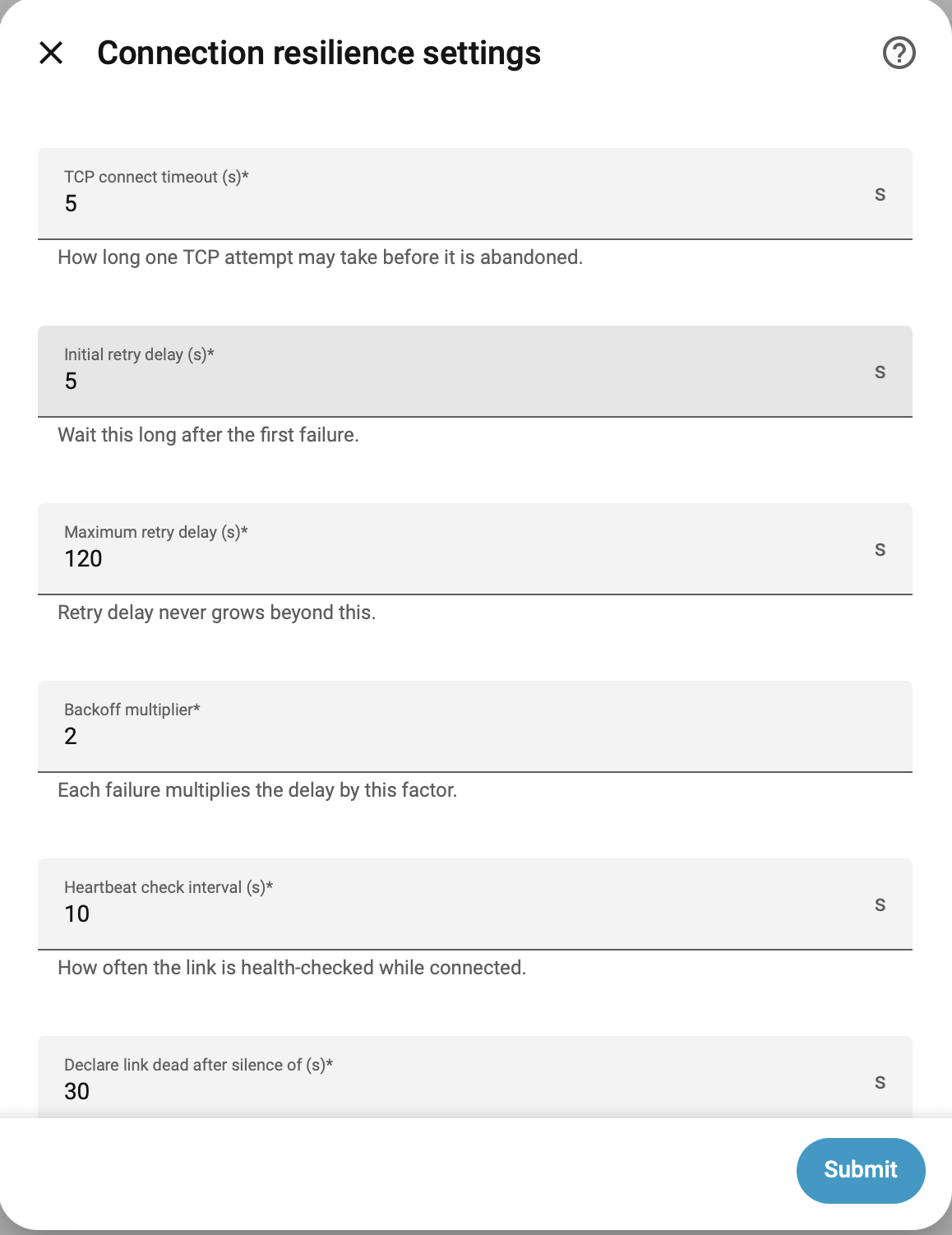

- Exponential backoff — 5 s → 10 s → 20 s → 40 s → 80 s → 120 s (all tunable in the UI, hot-applied without restart)
- Rolling uptime % sensor so you can see how flaky your specific module is
binary_sensor.<slug>_reachableas an automation gate — flips on only after the link has been healthy for N seconds (default 15 s), so commands don’t fire into a flapping link
