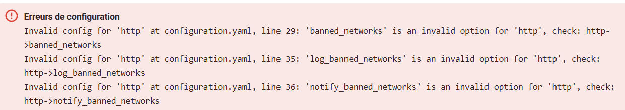

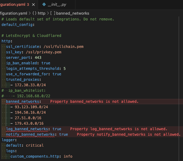

In the configuration.yaml: it shows "Property banned_network is not allowed as per the above attachment.

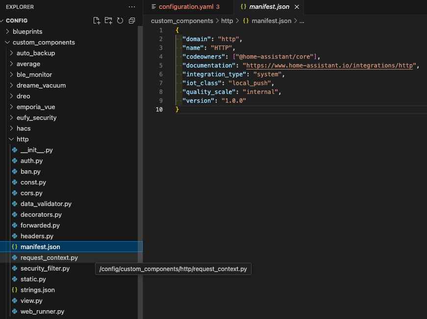

Version 1.0.0 is updated in the manifest.json as instructed.
Welcome @sakanaou
Are you saying it does not work for you?
The screenshots look like VSCode so I’m not sure why it’s telling you that the properties are not allowed. Maybe it’s checking them against the HA base code and not my fork?
Does it not work in Home Assistant as a custom component?
What’s in your HA logs?
Did you restart HA after adding the files to custom_components/http? I had a simular issue before restarting.
I have the same issue.
all files copied in custom_components/http
HA rebooted (not restarted)
When I add the lines
banned_networks: # Make sure the format is right, e.g. /16 must end in 0.0/16
- 111.7.0.0/16
- 45.0.0.0/8
- 179.43.0.0/16
- 123.160.0.0/14
- 195.178.0.0/16
log_banned_networks: True # optional as defaults to True
notify_banned_networks: True # optional as defaults to True
And I press “verify”, I get an error for the 3 values
When adding version in manifest.json, have u double checked that format is correct? (A comma-sign is needed at the end of the previous line)
Is there anything in the HA log saying it couldn’t load the http custom component at boot time?
Thx, I forgot the comma on line “quality_scale” just before version
