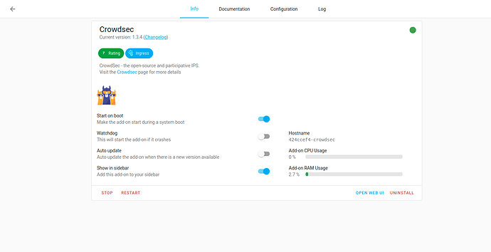

If you’re connecting your HASS directly to the internet for remoting purposes you can install CrowdSec on it to protect against hackers. CrowdSec is FOSS IDS/IPS and now available as a HASS add-on. HAOS 8 is a requirement. Here’s a few screenshots.
It consists of two parts: the agent which detects attacks and the bouncer which blocks them. Here’s instructions on how to install both the agent and the bouncer:

Hi @kameo4242 thanks for the Addon.
I have installed both addons, am i now secure?
Thanks
Thanks but I am no longer associated with CrowdSec so I can’t reply. You should ask @kameo4242 instead. I am sure he’ll be able to reply you in a satisfactory way.
You can check the logs but yes, if properly installed CrowdSec is preventing bruteforce attacks on your HA instance.

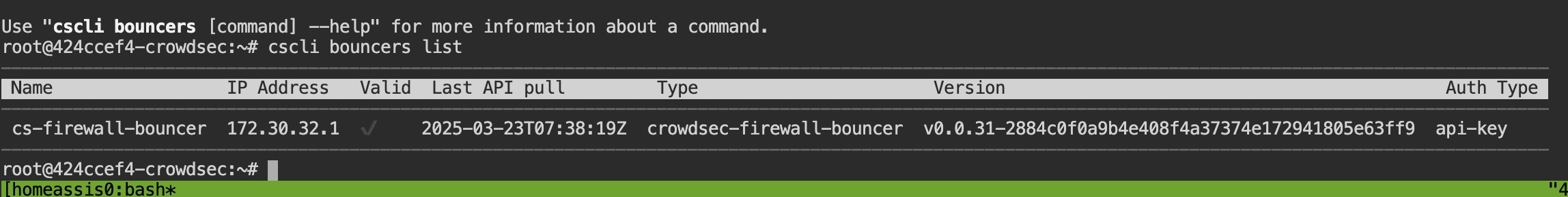

I have installed the addon for bouncer and crowdsec itself on HAm.
Opened the terminal, would that result mean that i am protected?
It sounds like it’s installed properly.
Use rather cscli alerts list or cscli decisions list to see if CrowdSec is blocking attempts but remember it’ll never take any action against a LAN IP (RFC1918), except if you disengage the LAN whitelist.
So if you want to test the efficiency of your setup, scan your machine from an external public IP address. It should be blocked and appear in decision list.
