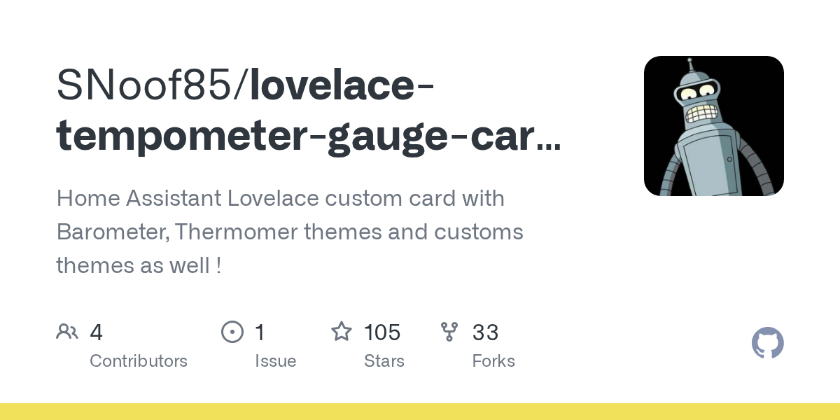

Hello in case anybody stumbles across this thread, the best barometric card is Lovelace tempometer-gauge-card which is native in HACS. Just need to set up two statistics sensors for the min and max pressure over the period you require.

HACS doesn’t list the tempometer-gauge-card. Has it been replaced?
This is old. Also look at ring-tile. Possibly better

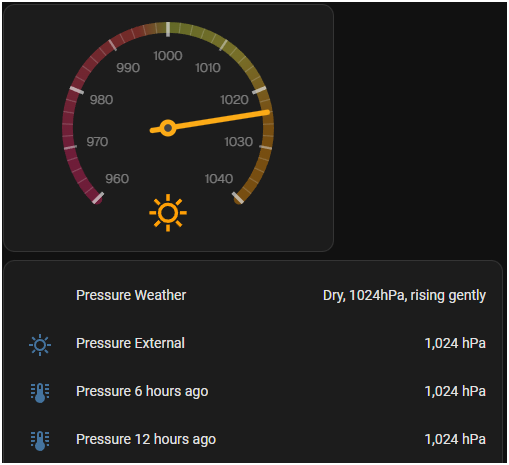

To update this thread my current set up is Ring Tile … you can not see it but there are two sub markers which show pressure 6 and 12 hours ago. And I have template to change the icon to match the old style weather clock
type: custom:ring-tile
entity:
  entity: sensor.pressure_external
  unit_of_measurement: mbar
marker: sensor.pressure_6_hours_ago_2
marker2: sensor.pressure_12_hours_ago
ring_size: 4
indicator: pointer
colorize_icon: true
top_element: null
middle_element: null
bottom_element: icon
scale: ticks_with_labels
min: 960
max: 1040
colour:
  "970": "#e91e63"
  "995": "#f44336"
  "1000": "#cddc39"
  "1013": "#ffeb3b"
  "1025": "#ff9800"
  "1043": "#ff9800"
card_mod:
  style: |
      --rt-ring-background-opacity: {{
          "40%"
