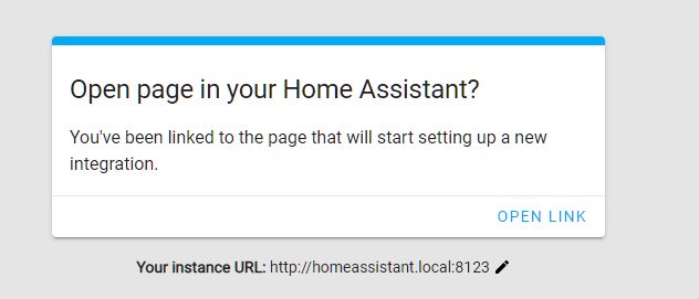

I clicked ‘Add Integration’ and got this
HA1
I clicked ‘OPEN LINK’ and got asked to login to HA again.
I’m already logged in but…ok…I’ll do it again.

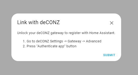

The only option was to click “SUBMIT” and got this
ha6
Very interesting - I didn’t even know I was looking for an API key
Where it says “Go to deCONZ Settings → Gateway → Advanced”…where do I find that?
I’m sure HA is great if you can interpret the gaps in these processes but for mere humans it is incredibly difficult at times.
