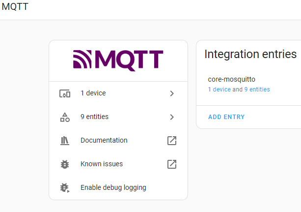

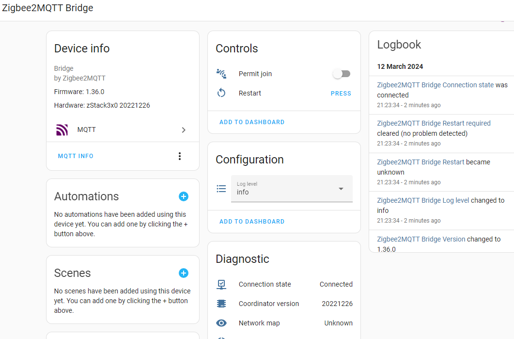

MQTT installed - this is showing 9 entities and one device. There is reference to Zigbee2MQTT Bridge deeper within

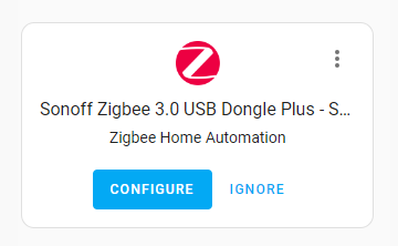

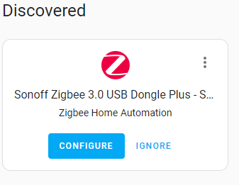

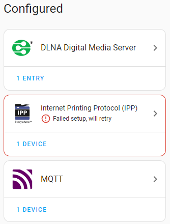

However under Settings>Integrations tab Zigbee Home Automation is in a red box with Failed Set Up - Will Retry showing. If I select re-configure from the three dots menu it says “ZHA will be stopped - Do you wish to continue”
Have you got both the ZHA and the Z2M integrations running at the same time? You can only do that if you have a separate dongle for each of them.
If you’re using ZHA there should be no reference to Zigbee in MQTT (in fact you don’t need MQTT at all unless you’re using it for something else); if you’re using Z2M you should disable the ZHA integration.
Zigbee Home Automation sees your dongle, but does not know it is already used by Zigbee2MQTT. So, if you want to use Zigbee2MQTT, the best thing to do is remove, the second best disable.
Thanks for the reply. The main reason that I think that I will need MQTT is that I hope to get Frigate working and think that MQTT is needed for this. I initially hope to install powered smart switches and plugs across the house to allow the Zigbee mesh to develop. Then battery powered sensors can connect to that mesh.

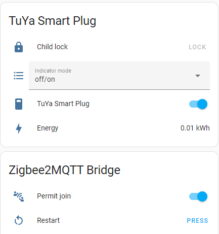

THANK YOU SO MUCH. I know that this is so basic - but you and @ Stiltjack have got me going with my first thing in Home Assistant! I started a year ago, gave up and put the project to one side and did nothing. However with answers to this recent question - you have got me going and given me the confidence to pick up this project and get re-started again.
So now I have the Zigbee MQTT running and got my first Smart Plug working - I can switch this on and off with my Companion App or via the browser. I am very happy! Now I need to learn adding this to a dashboard and use the information it supplies.
