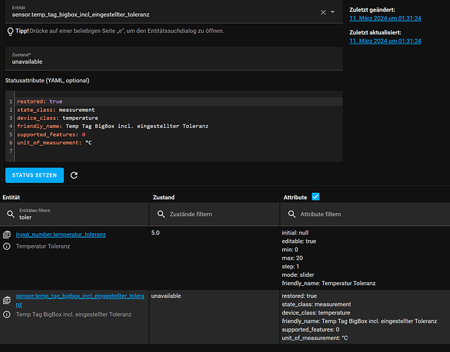

and thats my output
unavailable

i change now the code…and delte the spaces…no work… again unaivalable

is possible… the sliders what create the values
  • input_number.max_temperatur_tag
    and
    input_number.temperatur_toleranz
    make that problems?
