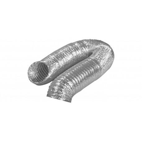

and its using this duct to funnel the steam etc out through the vent leading outside that is just above the ceiling:

Also I can not put in a duct because apartment below is using same shaft and it is has 15x12 cm cross section so it would effectively plug it with ducting.

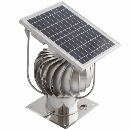

What I think I will do is talk with my neighbors about installing something like wind powered ventilation shaft cowl on the roof. Maybe with solar option depending on the price.
