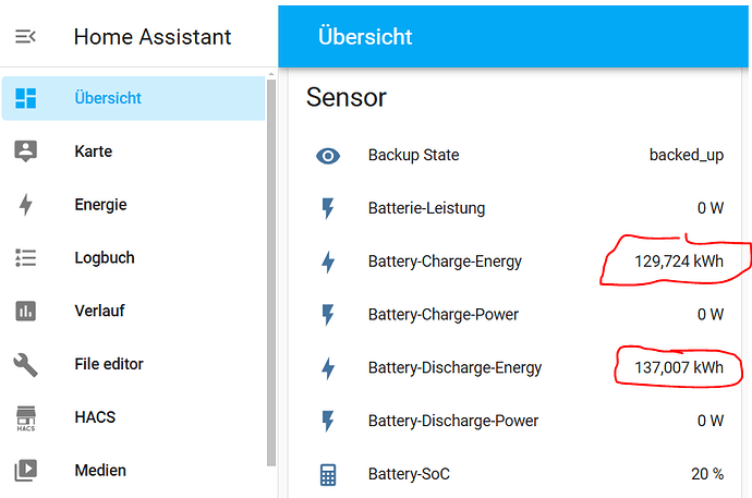

I’m wondering why the charged-energy in my battery is smaller than the discharged-energy. Normally it would / should be the other way round.

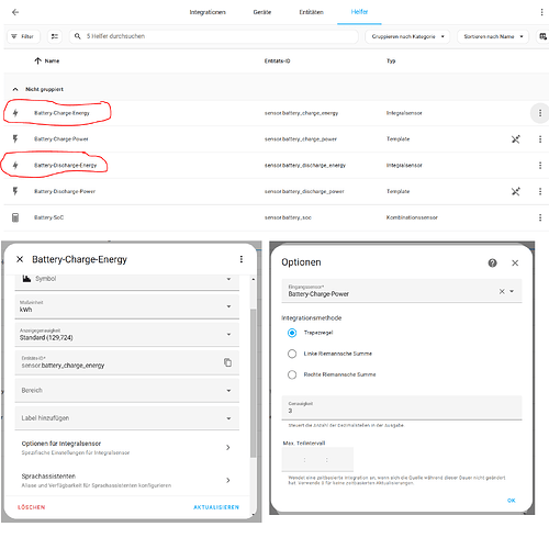

with this power-sensors i’m integrating the energy from the power via helpers
(here i wanted to add more screenshots which unfortunately is not allowed for new users. I’ll try to add them next…)
Any hints why the discharged energy is computed to a greater value than the charged energy ???

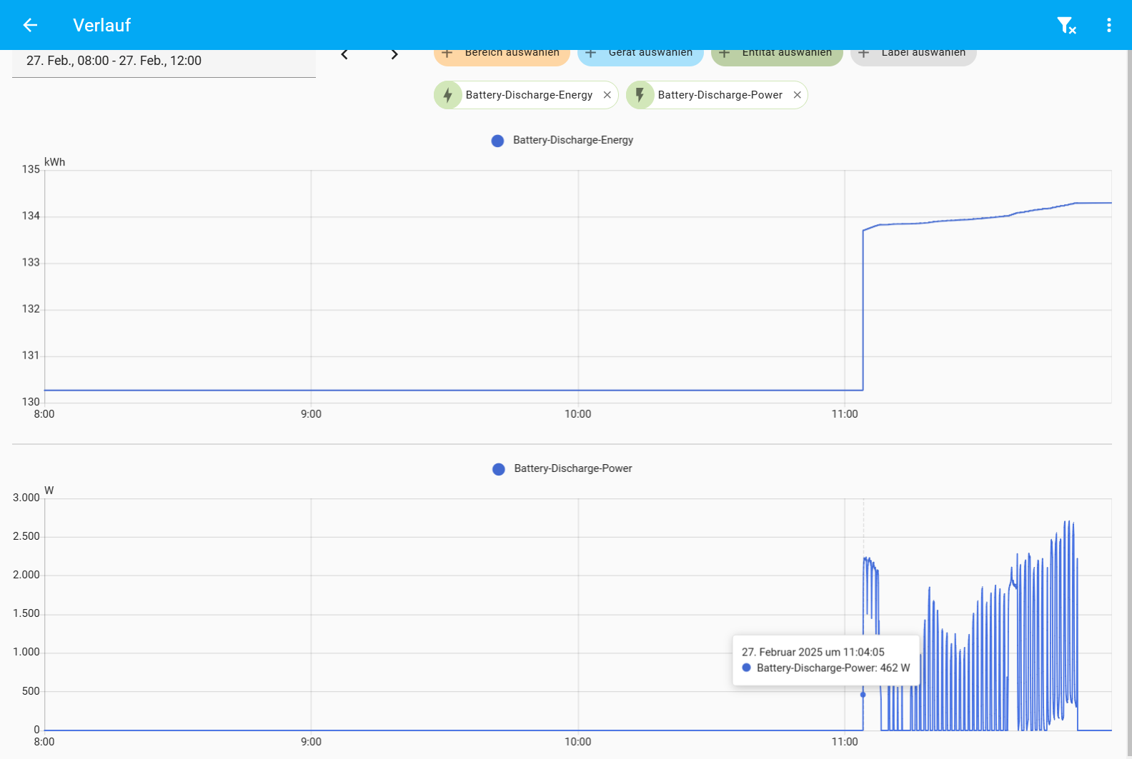

i started the computing of battery-energy ~ 4 weeks ago
from day to day the “discharged” energy grows bigger / faster than the charged energy…
battery-SoC every day starts from 20% in the morning and ends with 20% at evening/night
having a look at the energy “discharged” today i see a jump from 3kWh in 1min - which is definitely an error:

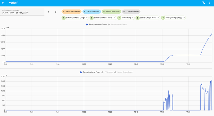

May “left rieman” integration be better than “trapezoid” ?
with “left riemann” it looks smoother:
