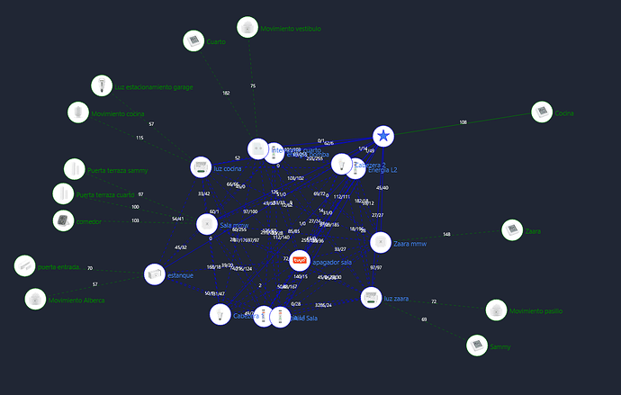

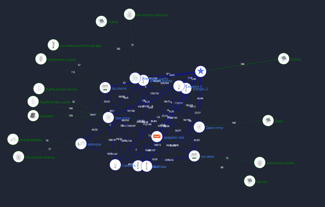

what do you use on HomeAssistant ZHA or Z2M?
there is so many adapters that you can use
this one is really cheap and it works.
SONOFF Zigbee 3.0 USB Dongle Plus ZBDongle-P
just remember you need a healthy mesh , so having only 1 device on your mesh is not recommended as many zigbee devices work as a repeater .
