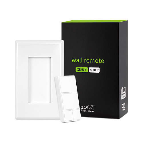

I like these Z-wave wall remotes because I can put a switch plate around them to look classy, or take it off the wall (it’s magnetic) if I need it closer. They’re also rechargeable. I think I got mine for about half price during a Zooz sale.

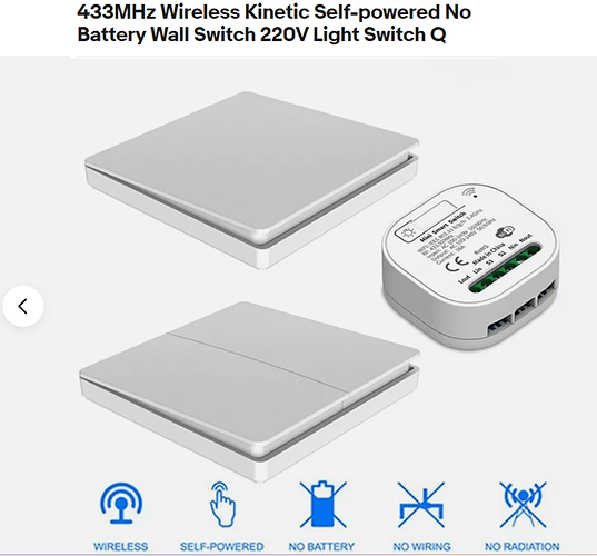

If there was just some way to use kinetic switches
Thanks for that! I got some of these, but did not manage to connect them to HA. They are not recognized by OpenMQTTGateway. Did you manage to use them with HA? If so, I would be thankful for a hint how :slight_smile:
Sadly not so far. There was a youtube video but I haven’t tried to copy it yet.
Just fyi, I managed to get these buttons working. Unfortunately, it does not work with OMG, but they work with the original rtl_433 lib and an RTL dongle.
